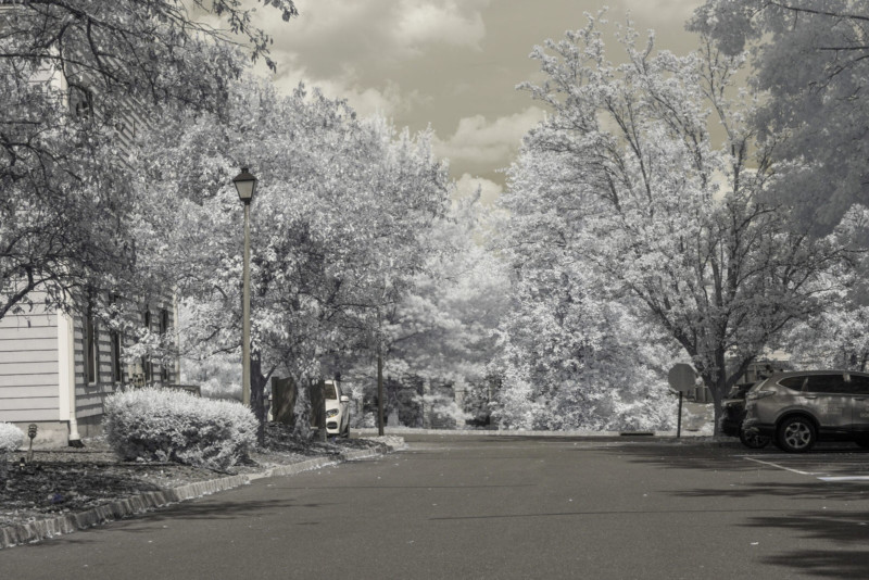

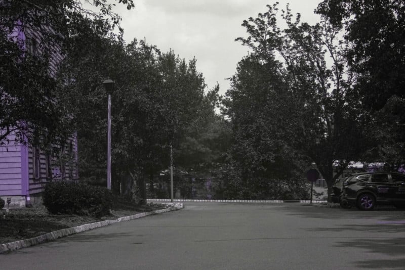

Test #1: Snapshots of our parking lot in strong sunlight
Kolari IR 720nm
B+W 403 Ultraviolet
Kolari UV Bandpass
We can immediately see a clear difference between all 3 filters, and that the B+W 403 is performing much more like a near-infrared filter than a UV Pass filter. Leaves and foliage are usually highly IR reflective leading to bright if not completely white vegetation in infrared images. While producing some different coloration, the 720nm and B+W 403 both prominently display this property.
Our UV pass filter, on the other hand, creates very dark if not black foliage. We can also see that the most UV reflective object in the frame is the siding of our building. This is likely due to a UV reflective treatment to the siding to protect from long term sun damage. To Fuji’s credit, the 60mm F/2.4 Macro is actually a good lens for UV photography.

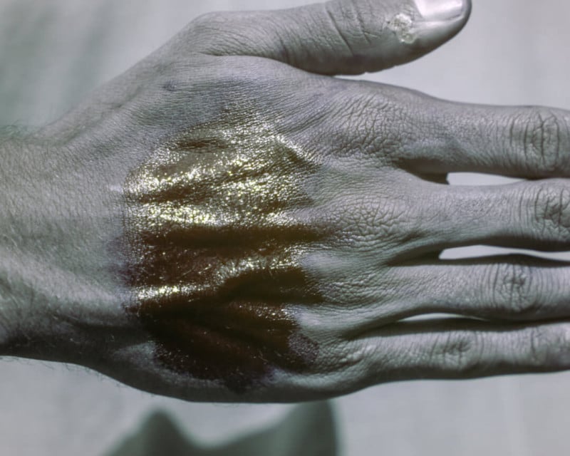

Test #2: Sunscreen Lotion
Kolari IR 720nm
B+W 403 Ultraviolet
Kolari UV Bandpass
As of late, filming in UV has been a favorite method for companies to advertise the effectiveness of their sunscreen lotion, so we’re using that method in reverse here. If the sunscreen is absorbing UV light, it should appear very dark or black. Though the lotion does glisten brightly from certain angles, our filter is the only one showing UV absorption while the B+W 403 is once again performing more like an infrared filter.
Interestingly, the lotion seems almost transparent when viewed through the B+W 403 Ultraviolet. On another side note, the healing wound on my thumb contrasts much more strongly with the surrounding skin with the Kolari UV Bandpass than it does with the B+W UV or the 720nm IR filters. These characteristics are all very strong indicators of whether or not an image is composed of purely UV light or if it is contaminated with other, undesired wavelengths.

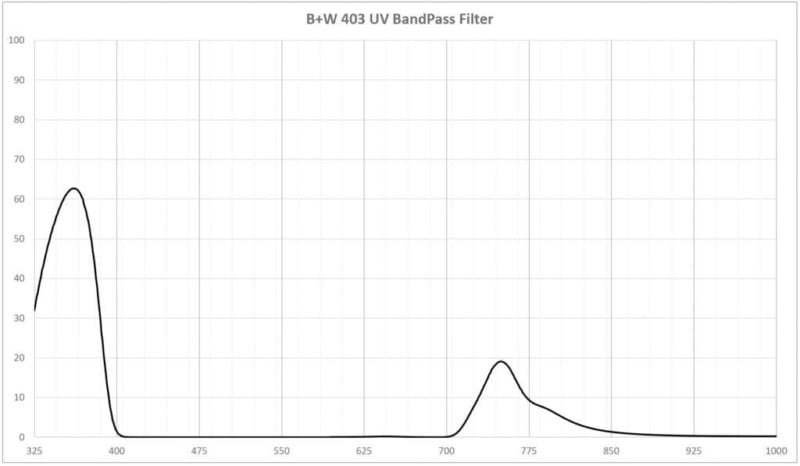

Filter Transmission
A look at each filter’s spectral response curve as measured by our spectrometer shows the underlying reasons why both of the UV pass filters are producing such different results. Our UV Bandpass filter on the left is blocking enough infrared light to prevent contamination of the image. Due to the much higher sensitivity, most sensors have to block the out of band signal VERY strongly. We found during development that even 0.1% transmission peaks could wash out the UV signal.
As you can see from the graph, the B+W 403 Ultraviolet is letting in so much infrared light alongside the UV that it is almost completely overpowering the exposure, leading to what is essentially a near-infrared image. The only way the B+W 403 could be used on its own to create a purely ultraviolet image is in a controlled environment with no infrared light present, or to use it with UV film with no IR sensitivity, AKA how it was initially designed to be used.
