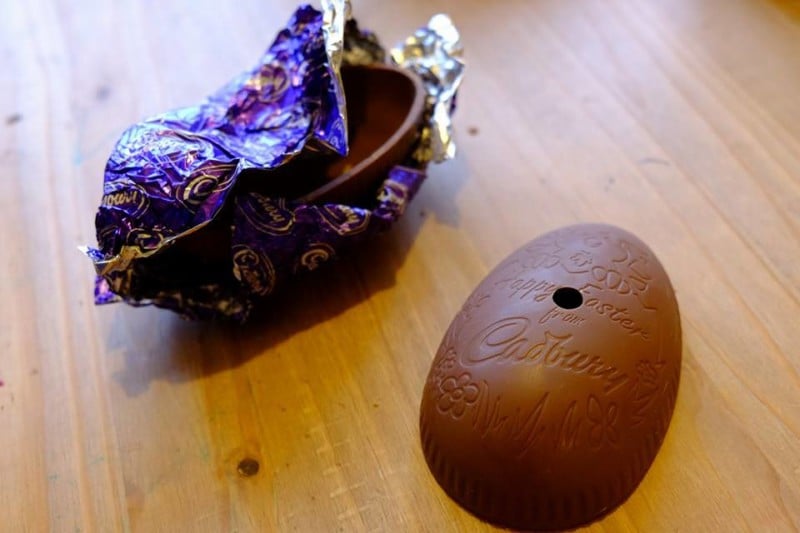

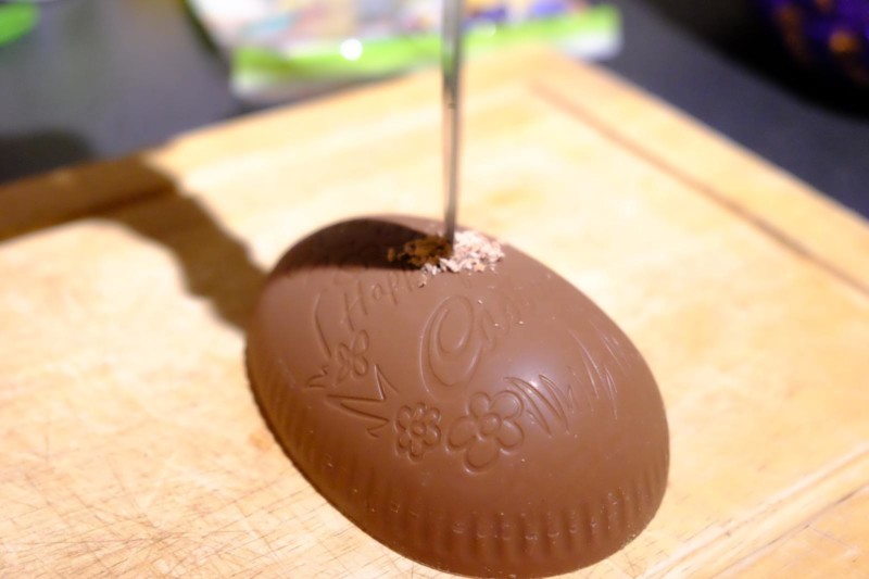

When I was happy it wasn’t going to melt too quickly, I cut a small hole in one half.
Cutting the hole with a sharp knife
Over this hole, I placed a thin strip of aluminum with a pinhole in it. I kept the egg in the freezer again until I was ready to put it together.

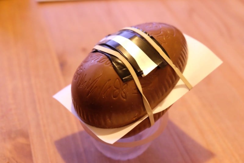

In a darkroom, I quickly and gently lined the two egg halves together with some B&W Ilford MGIV Photographic paper between them both. The pinhole was held in place with some black tape and 2 elastic bands held it all together, I then lightly wrapped the egg foil back around to reduce the amount of light getting in between the halves.
When it was ready I place some black insulation tape over the pinhole and was ready to get it out the darkroom for its 1st test shot.
All together

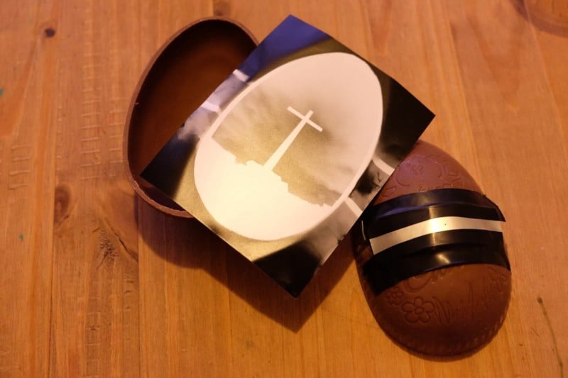

Headed back home to the darkroom and set about taking it apart and developing the photo.
The egg with the negative image after being developed.

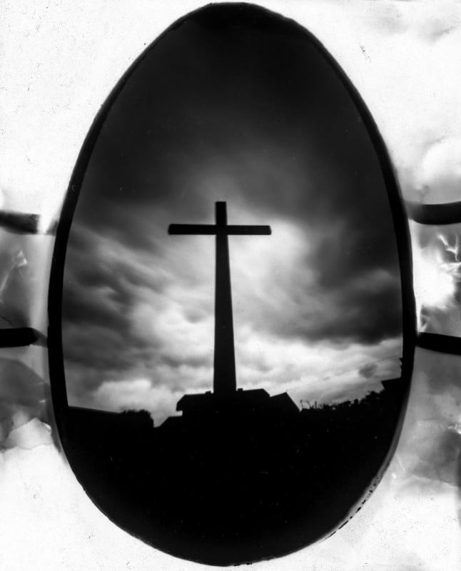

The final result after it was scanned and converted in Lightroom
Crucifix photographed with a chocolate Easter Egg
All together
