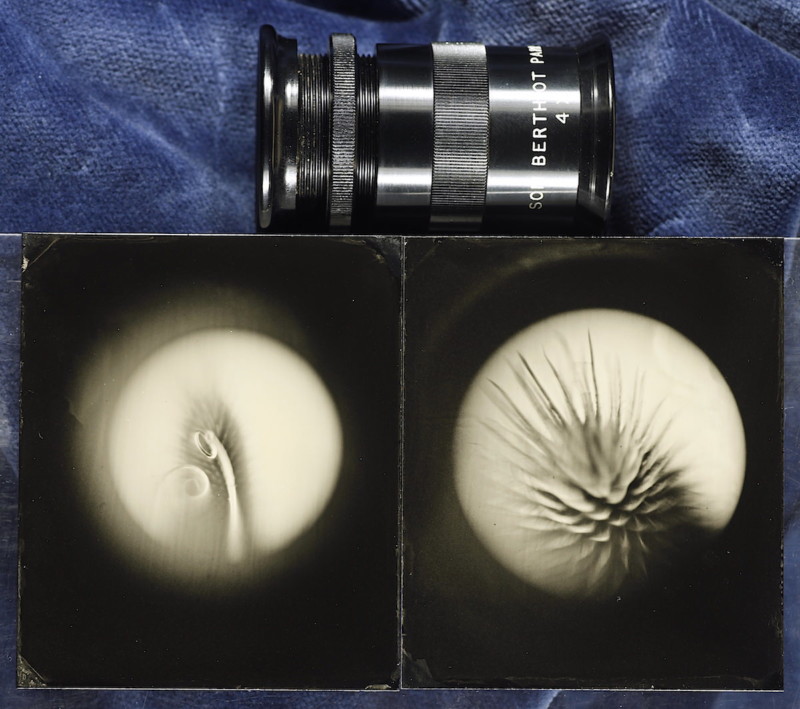

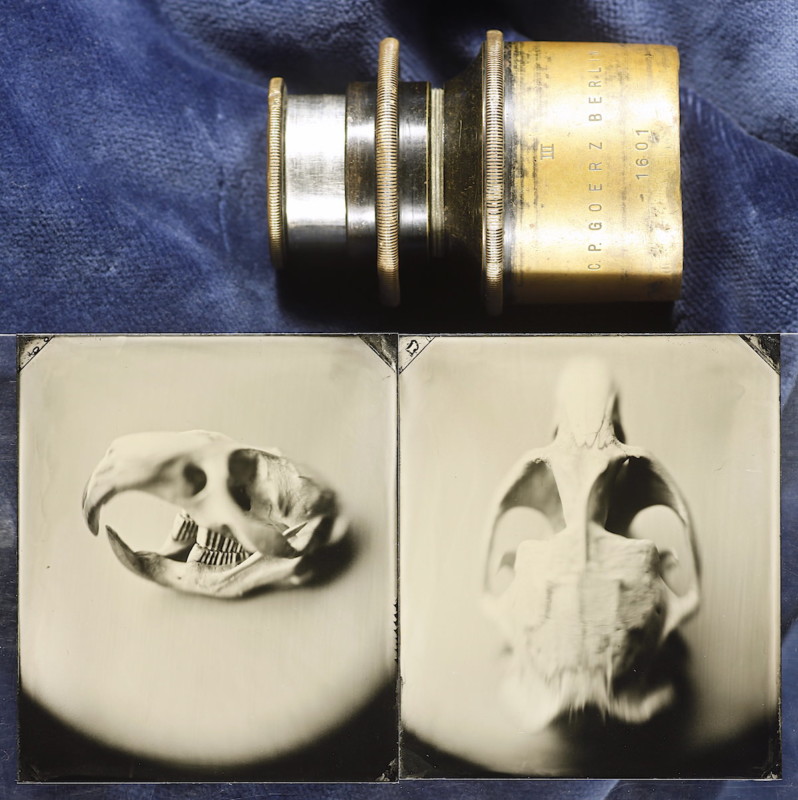

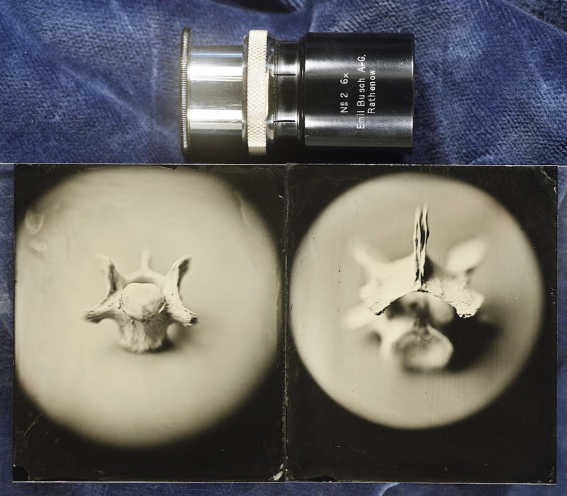

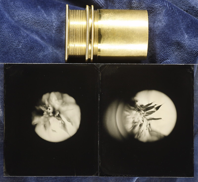

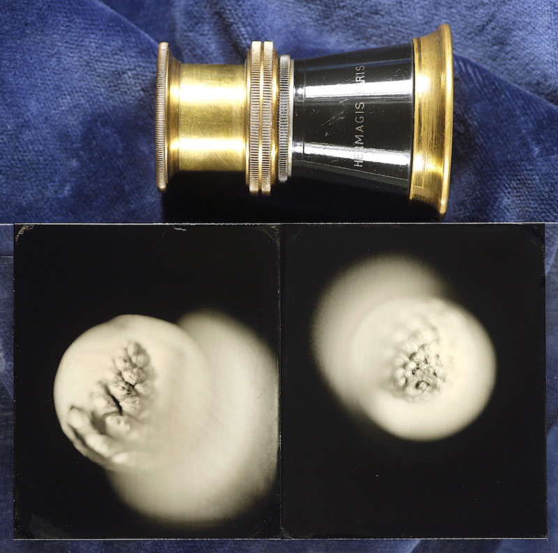

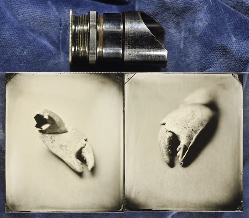

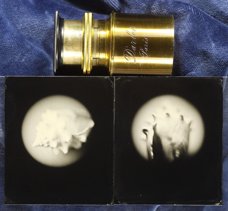

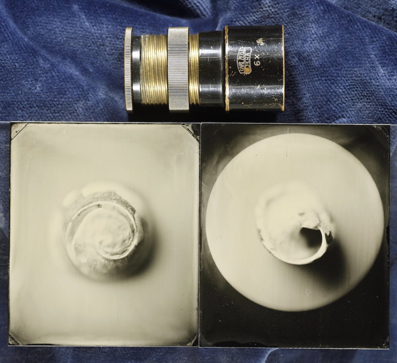

Below images show two tintypes and the loupe they were captured with, with images positioned by the respective end through which they were shot. Each plate is 2.75×3.25in, which is a traditional 1/6th plate size; from that, you can judge the circle of coverage as well as the approximate scale of loupes pictured.
Early Dallmeyer
Darlot
Emil Busch
C. P. Goerz
Hermagis
E. Krauss
E. Anthony
Ross
Scovill
SOM Berthiot
Steinhell
Zeiss Jena

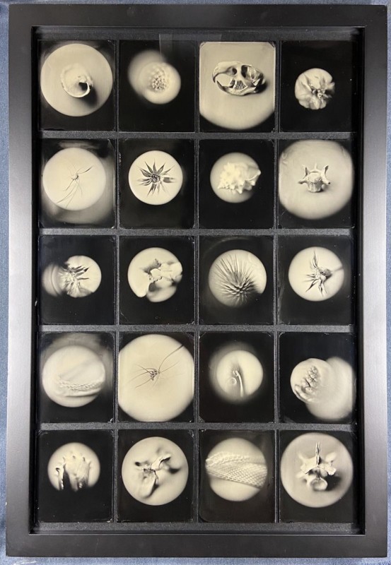

In the end, I picked 20 images to make this collage in a 12×18 inch frame.
Twenty 1/6th plate tintypes in 12×18-in frame
