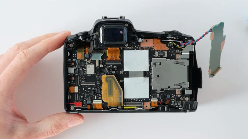

After using a thermal camera and noticing a hotspot appearing on the back of his camera during video recording, Matt opened up the R5 and examined the rear internals. He found that the camera’s main processor is the culprit that generates a great deal of heat during recording and that the thermal pads covering the processor don’t seem to be positioned very well.
Matt discovered that the processor under strangely positioned thermal pads generates a considerable amount of heat. Still frame from video by DIY Perks.

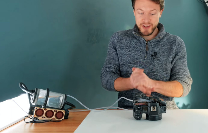

Since the processor is positioned under a power board and the camera’s back panel, Matt decided to use a thin strip of copper to pull heat away from the processor, out of the camera, and to a watercooling system. It’s not exactly portable or beautiful, but it’s functional.
The completed watercooling mod. Still frame from video by DIY Perks.
When he tested the camera, though, it still shut down after 20 minutes with the overheating warning despite the processor not being too hot at all.

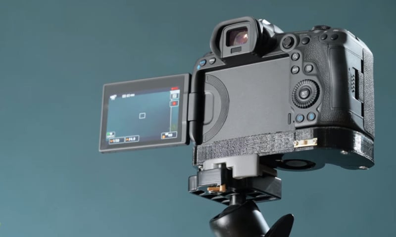

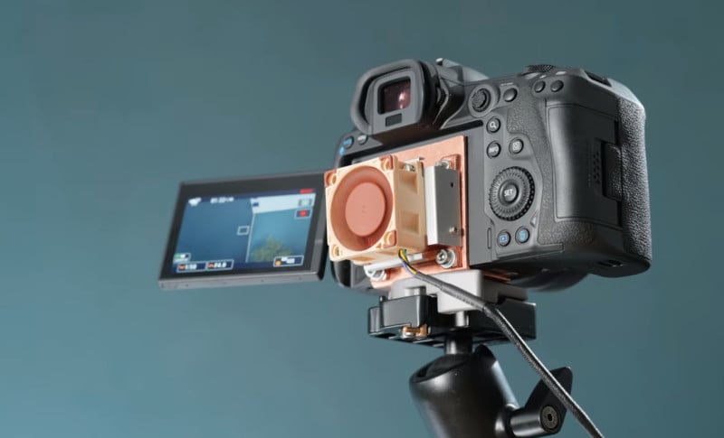

Having confirmed that proper cooling can make all the difference, Matt set out to find a more compact solution for extending his camera’s recording times. By creating a custom internal copper heat plate, a custom rear-mounted heat sink, and a custom external base-mounted fan, Matt was still able to cool the camera down the same amount.
The copper plate alone provides 39 minutes of recording at room temperature, the addition of a base-mounted fan provides unlimited recording at room temperature, and the addition of the rear-mounted heat sink provides unlimited recording at higher ambient temperatures.
Matt’s successfully modded Canon R5 with an internal copper heat plate and an external base-mounted fan. Still frame from video by DIY Perks.
