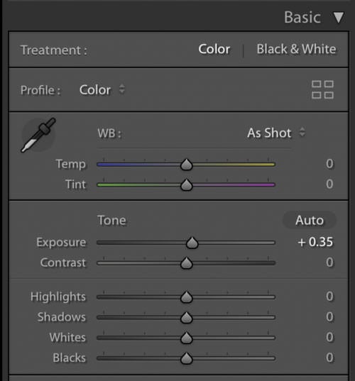

Assuming Lightroom is the editing weapon of choice, (other editors are very similar) the first thing to do is create a virtual copy of the image. This acts as a print file without upsetting the original edit.
Looking at images on a screen, the perfectly backlit monitor adds brightness to the image, even with a calibrated monitor, which creates and evenly illuminated picture. Once printed, the image is front lit and room light can be inconsistent and the image is at risk of looking dull.
This can be compensated for by increasing the exposure by about a third to half a stop. Not too much to blow out the highlights, but just enough to give the brightness a little boost and avoid disappointment.

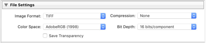

Printing at home is easy because we can print directly from Lightroom using the print module. The higher end Canon printers also come with Canon Print Studio Pro. This Lightroom plugin gives ultimate control over your prints and is designed to work with those specific printers.
The lab will not be able to read a raw file so the photo will need to be exported as an image file. Most good labs accept a wide range of file types to provide ultimate versatility to customers. However, to get the best quality, the preferred file format to use is a TIFF file. These are uncompressed so no information is lost like it is with a JPEG. The file size will be much bigger but the results will also be more accurate.

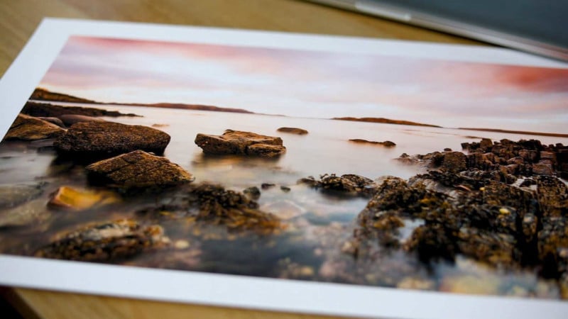

Accurate color is important because we want our images to print out to match how they were edited on the screen. A beautiful orange and pink sunset will be ruined with a print containing a nasty green tinge. There is a lot happening to go from screen to paper, so we must use ICC profiles to make it easy.
ICC profiles are plugins for photo editors that are based on the type of printer being used and the type of paper we choose. Once installed into software such as Lightroom we can enable soft proofing in the develop module, select the paper being used, and the ICC profile will simulate how the print will look on paper. Adjustments can then be made as required prior to print.

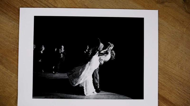

Matte or Rag paper: Good cotton rag paper is the best bet for a matte finish. Good rag papers will have a high DMax rating which means they hold the blacks very well. Rag papers are perfect for black and white images because it holds really strong contrast. They are also great for certain landscapes and color portraits when a more muted fine art feel is required.
