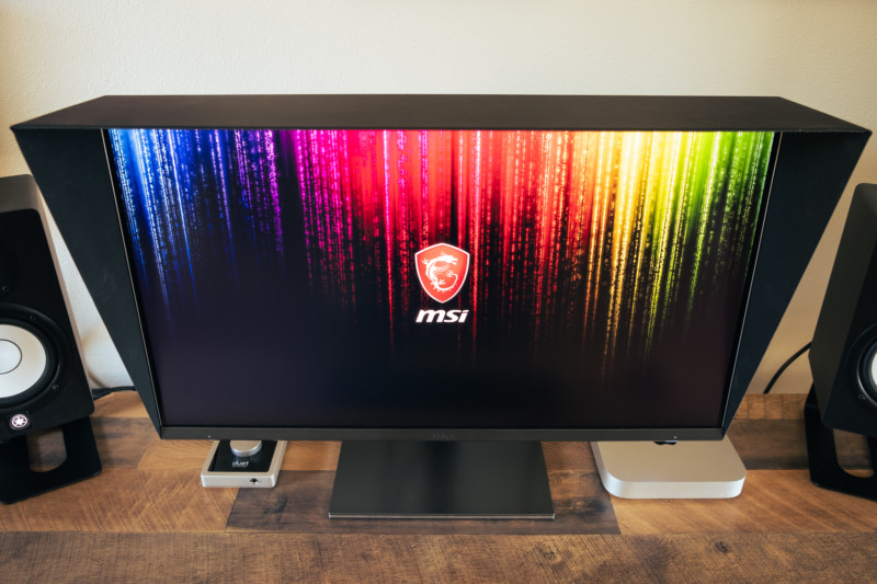

Finishing off the aesthetic touches is a magnetic shading hood that’s extremely easy to install, but is really too small to be considered anything but decorative. Your mileage may vary, but I basically only put the hood on once to test it, after which it spent the rest of its short life on top of the monitor’s box in a corner of my apartment.

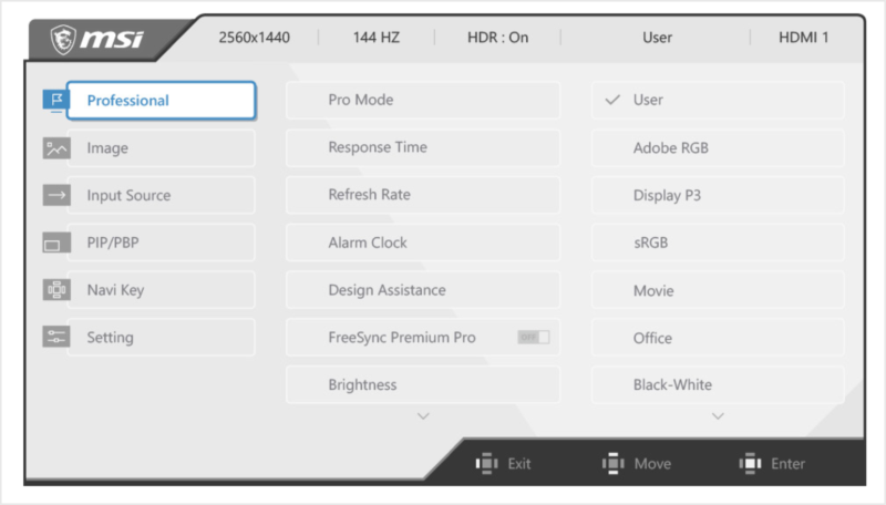

For navigation, the monitor uses a clickable joystick (called a “Navi Key”) that allows you to set four pre-assigned quick-access menus to top, right, bottom and left directions, or access the full menu by clicking in.
Once you’re in the menu, you get a plethora of panel controls that let you change basically everything about the monitor’s output: Brightness, Contrast, Color Temperature, Hue, Saturation, Gamma, and Gray Level are all adjustable. There’s even a Sharpness slider and an “Image Enhancement” option that can be set to OFF, Weak, Medium, Strong, or Stronger, though I would suggest leaving both of these on zero/OFF unless you like the contrasty, over-sharpened look.
Under the “Professional” menu, you get access to a Pro Mode that lets you switch the display’s primaries to AdobeRGB, Display P3, sRGB, and a few other presets, as well as settings for Response Time, an Anti Motion Blur feature, the ability to turn on FreeSync Premium Pro, and a few other nice-to-haves.
For photographers, the main draw will be the Pro Mode options and all the display controls, but I’d suggest leaving most of that alone and simply calibrating the custom “User” setting so you’re taking advantage of the panel’s full native color gamut. For gamers, you may want to tweak your pixel response time to taste, or turn on FreeSync if you’re using a compatible graphics card.

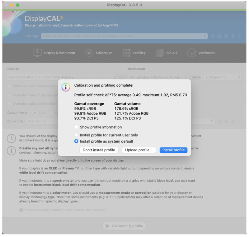

In terms of color performance, the MSI Creator PS321QR delivers what it claims to on the box.
In our testing with an XRite i1Display Pro Plus and the DisplayCAL software, the monitor does indeed hit 99.9% AdobeRGB and 99.9% sRGB, though we only hit 93.7% of DCI-P3 (advertised was 95%). Delta E was also measured at less than two on all color patches, even when we ran a more extensive patch test. In fact, the maximum on a more thorough evaluative test was just 1.23, which is just plain excellent.

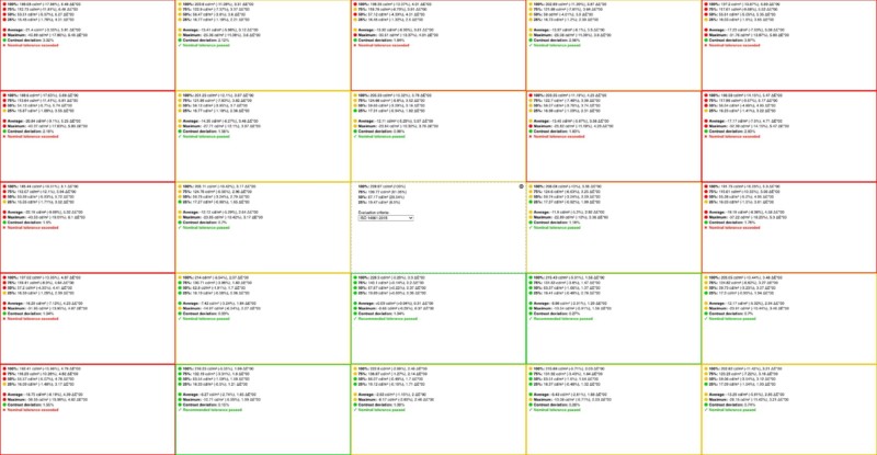

Where the monitor under-performed was uniformity, and this is where its focus on gaming begins to hurt its performance as a photo editing display. Most proper “creator” monitors employ some sort of uniformity technology to make sure the panel is delivering the same color and brightness across the whole display. Unfortunately, the PS321QR uses no such tech.
When running a 5 x 5 patch test in DisplayCAL, 10 of the 25 patches failed, 11 passed only nominal tolerance, and only the remaining three (the center patch is the standard against which the rest are measured) actually passed “recommended” tolerance. For professional photo editors, this is the kind of detail that keeps them buying brands like EIZO or NEC.
You can see the results below (click for full resolution):
DisplayCAL Uniformity Check for MSI Creator PS321QR

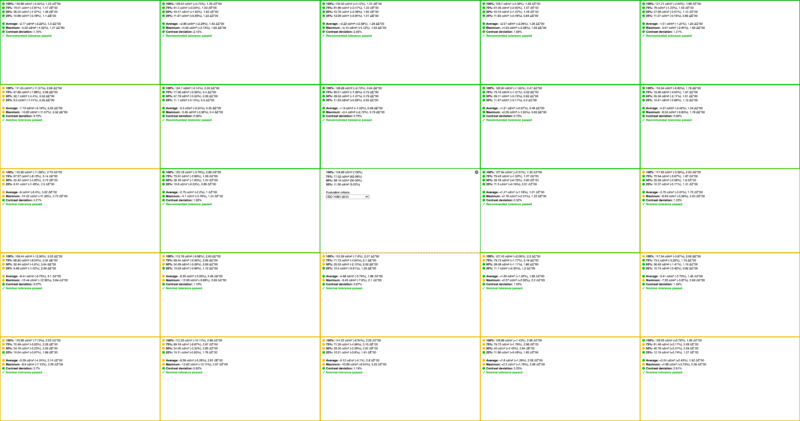

By comparison, even the semi-affordable BenQ monitor we reviewed last month passed at least the nominal tolerance on every single patch, and hit the recommended tolerance on half of them.
DisplayCAL Uniformity Check for BenQ SW271C

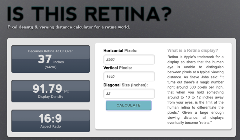

And if you’re a pixel density freak, the monitor’s 2K resolution (also known as Quad HD) leaves me wanting more from a 32-inch display. According to Is it Retina, at this combination of resolution and screen size, you should stop seeing the pixels from a viewing distance of about 37 inches; but even if that seems workable, it leaves you with less screen real estate for multitasking.
After using a 4K monitor, the icons and windows will look huge unless you scale the display output beyond its built-in resolution.

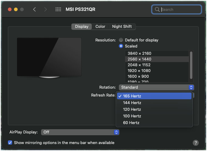

On the gaming side, the monitor’s main trick can be summed up in one word: speed. The PS321QR can ramp up its refresh rate from 60Hz all the way up to 165Hz at a gray-to-gray (GTG) pixel response time of just 1ms when response time is set to “Fastest” in the user menu. That is very fast, and it is definitely noticeable, although I’d recommend keeping pixel response time set to “Fast” to avoid overshoot/inverse ghosting artifacts.
Admittedly, I’m not a big gamer, but the benefits of a high refresh rate monitor were obvious, even to me. Something as simple as moving between virtual desktops looks tack sharp compared to 60Hz, and gamers will tell you that this initial jump from a standard 60Hz monitor up to 120Hz or 144Hz is the most noticeable. From that point on, you suffer from the law of diminishing returns, spending more money to make the jump from 144Hz to 240Hz or even 360Hz, without noticeably affecting your gaming performance (assuming your GPU can even push 240 or 360fps in-game).
