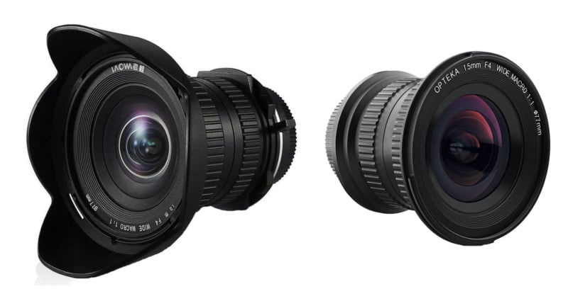

The concept of wide-angle macro photography is not exactly new and there are other photographers out there who have built their own super-wide macro lenses. There even are a couple lenses on the market that provide 1.0x at a 15mm focal length, but I’d much rather embark on an interesting DIY project than spending 500$ on a niche lens.
The Venus Optics Laowa 15mm Macro lens and its much cheaper competitor.

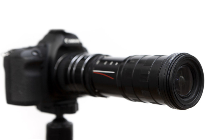

Basically there are two different ways to combine close-focusing capabilities with a wide-angle look:
1. Extension Tubes
The easy way, and probably the one that comes to mind first, is to mount a wide-angle lens on some extension tubes. This can work, but only to a limited degree.
If the tube is too short, the desired magnification won’t be achieved; if the tube is too long, the image circle gets cropped and the wide angle captivities of the lens will be offset. Plus, if the a lens is too wide in relation to the length of the tube, the focusing plane shifts into the front element and the aerial image can no longer be focused on.
So we are balancing three corners of a triangle and, much like with the well-known exposure triangle, you simply cannot have everything. The factors are: viewing angle, the lens’ size, and its working distance. Keep this triangle in mind, as it will play an important role in this article…

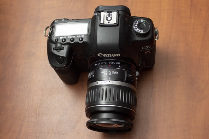

A Canon EF-S 18-55 II on a 12mm extension tube, mounted to a full frame camera body.
One combination that I found to work particularly well was the Canon EF-S 18-55 kit lens on a short extension tube, mounted to a full-frame camera.
The short-back focusing of the EF-S lens makes it penetrate further into the APS-C body that it’s meant for, prohibiting the use of EF-S lenses on full-frame cameras. The image circle would be too small and the rear element of the lens would likely damage the mirror and shutter mechanism. A short extension tube can solve that problem, extend the image circle enough to cover a 35mm sensor, and allow the lens to focus much closer.

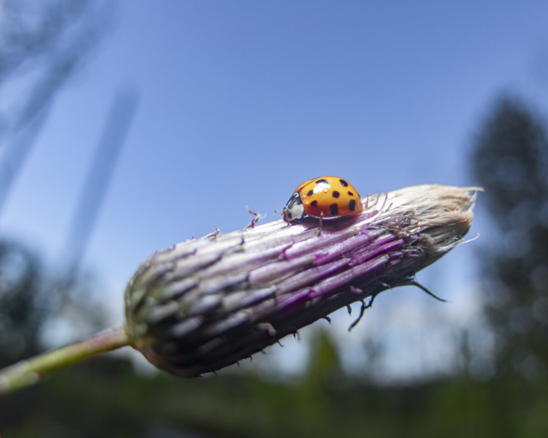

A Painted Lady on wild clover.
A common bug on yellow moms.

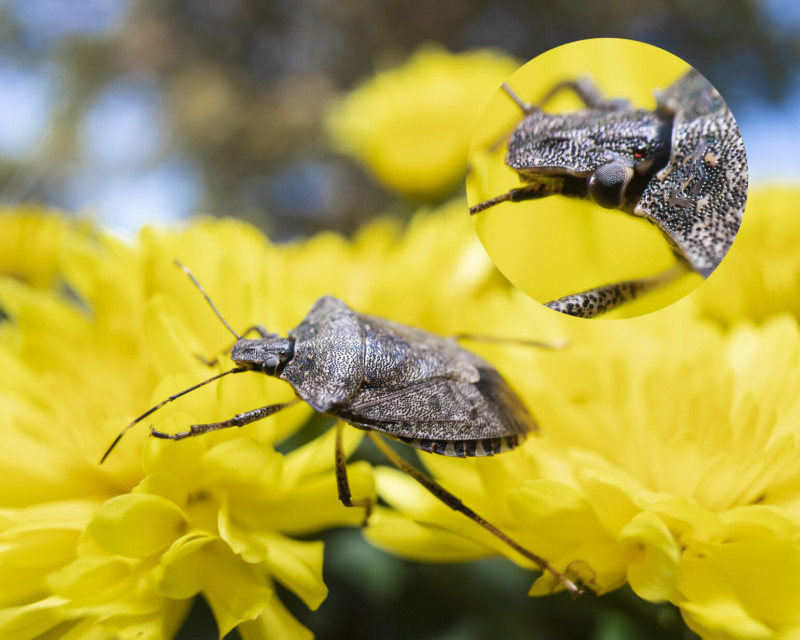

Same bug, slightly cropped and showing off detail at 100% resolution. Even though the image won’t be displayed at full res in your browser, it should be sufficient do demonstrate the sharpness of this set.

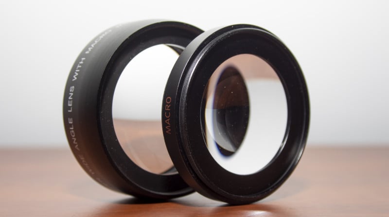

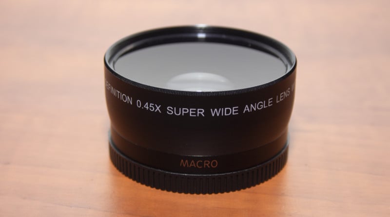

Fish-eye/macro converters were the first thing that came to mind. Such converters usually consist of two parts: A macro lens, which is basically a close-up filter (the rear element of the converter) and a fish-eye/wide-angle lens that sits on top of it.
The “macro” element allows for a compact lens design; without it, the wide-angle element would have to be much further away from the lens for the aerial image to line up with the focusing plane.

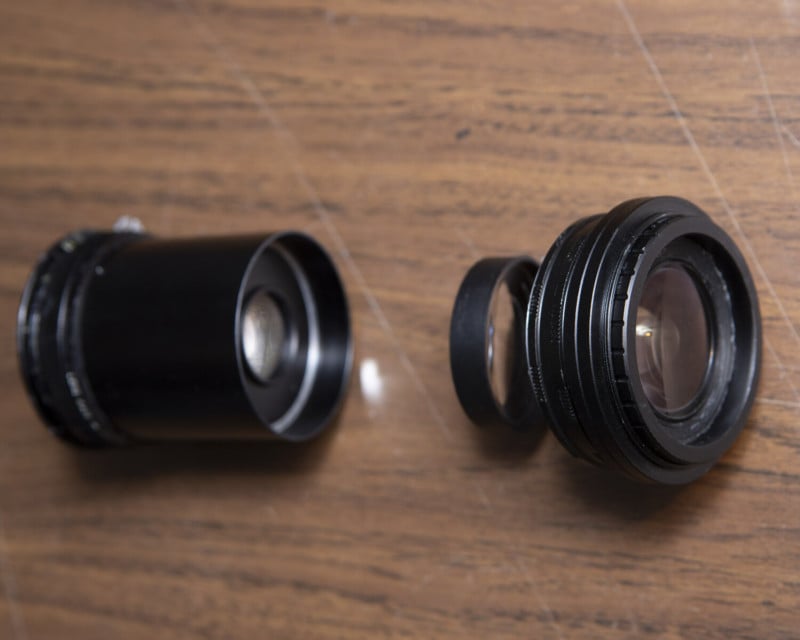

The full super-wide angle converter.
The two single pieces of the same converter.
Unfortunately, such converters don’t allow you to get quite close enough with the full ensemble attached to your lens, and the macro lens by itself alone doesn’t provide the desired viewing angle.
It is, however, possible to use such conversion lenses to create a super-wide macro lens. In order to gain 1.0x magnification we need to be able to focus incredibly close. By moving our new front element further away from the lens and closer to the subject, we can shift the focusing plane, similar to the effect of an extension tube.

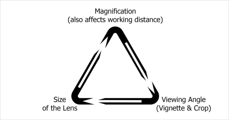

The Triangle of Balance
  • To achieve enough magnification, we will have to sacrifice some of the viewing angle by cropping the image circle with extension tubes and/or using a front element that isn’t as wide.
  • For a wider viewing angle, we have to move the wide angle element out further (and likely compensate for the shrunken image circle this produces by using extension tubes) and sacrifice working distance; the wider the lens, the further away things seem. Or, we find a wider piece of glass, which in return will result in a shorter working distance.
  • To reduce the size of the lens, we will have to trade off either some of the magnification ratio or accept an image circle that won’t fill the sensor… or a combination of both.

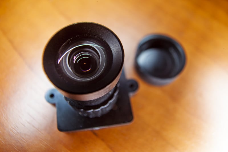

My first choice here was a fish-eye CCTV lens, as its super-wide field of view and its small diameter would make it the ideal lens for photographing insects in the field (the small size would be much less intimidating to potential subjects).
I got the best results in combination with a reversed 24mm lens, but unfortunately its image circle was far too small to even fill an APS-C or even a Micro 4/3 camera sensor. Naturally, the image can be enlarged by adding extension tubes and that’s what I did; to a certain extend. The problem is that, with super-wide lenses like this, the working distance will eventually turn negative, which means that the aerial image moves into the actual lens and can no longer be focused on.
Unfortunately, that effect came into play before I could fill the (APS-C) sensor of my camera, and it occurred with all base lenses I tried. In addition to that, the excessive use of extension tubes can decrease the image quality, as the enlargement amplifies flaws of the optics such as chromatic aberrations or limitations in sharpness. Alternatively a tele-converter could be used to “zoom in” without affecting the working distance, but adding another block of glass (especially a tele-converter!) would decrease the image quality too much.

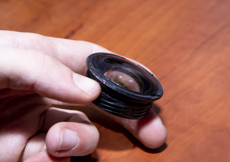

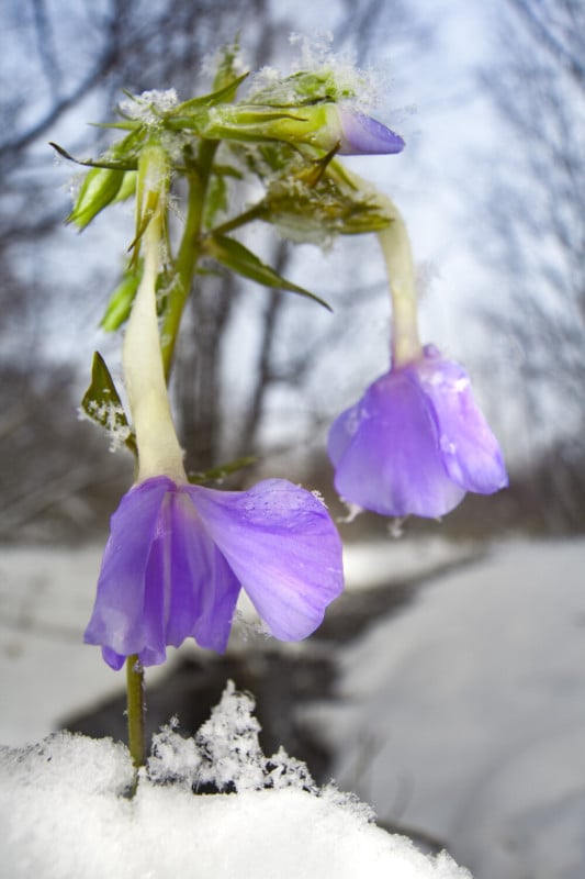

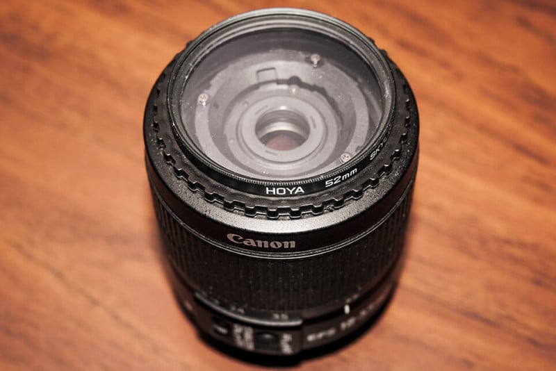

My next choice of glass was the former front element of a Canon EF-S 18-55 kit lens, which I modified for extreme macro photography last year. Most standard zooms can be modified for macro photography beyond 2.0x magnification simply by removing their front element. I did a few of these conversions over the past year and so I had some wide angle front elements at hand.
A modified kit lens that yields magnification ratios of up to over 2x.
The front element of this lens performed great in terms of image quality and was able to cover the entire sensor at 0.8x magnification with very minor vignetting. After inserting an additional (convex) wide angle element (from an Opteka 0.35 fish-eye converter), the vignetting disappeared and the magnification ratio reached 1.0x in the center of the frame with very good sharpness.
A test shot, taken with the set-up below; this lens provides true life-size at a viewing angle of less than 20mm.
This lens met almost all the conditions I had set for this project. The only downsides where the missing focus mechanism and the lens’ requirement to sit on a full stack of extension tubes, which makes it impractical to use and carry. A focusing mechanism could easily be installed by replacing one of the tubes with a helicoid, but the problem of its length seemed to lie with the base lens…

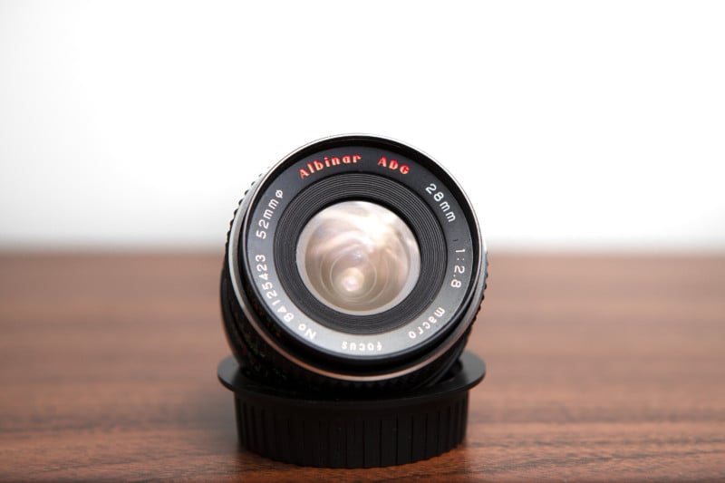

So what would the ideal base lens look like? It would obviously have close-focusing capabilities, a wide angle perspective, and a fairly small front element to avoid vignetting. So If I used a wide-angle base lens and mount it, facing frontwards, on just one slim extension tube, that should solve all my problems.
The lens I picked was a 28mm Albinar lens, which offered a perfect compromise between a wide perspective and only minor vignetting. I mounted it on an EF-adapter and some step-rings that function as a short extension tube.
Next I tried to combine it with the Canon front lens, and it worked incredibly well! No vignetting, good contrast, and the best part: no need for extension tubes needed and the new front element needs to be just about an inch in front of the base lens.

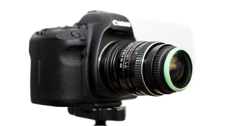

The Final Lens

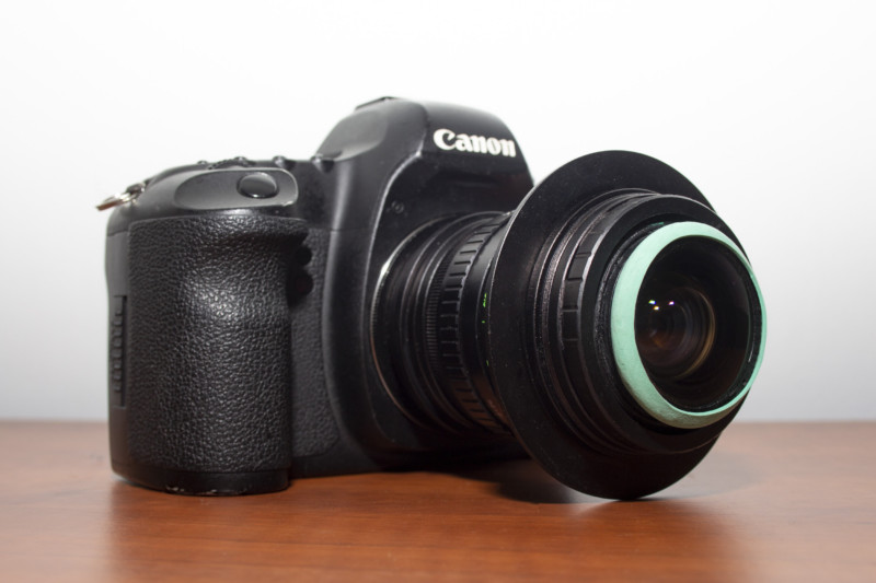

The more or less final lens: A 24mm wide-angle lens on a short extension tube, combined with the front element of a quality zoom lens.

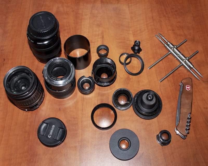

The front element of the Canon 28-80mm was a perfect fit in terms of size and viewing angle. It yielded better results than the front element that I tried previously and was easier to adapt and smaller in size as well, which is an important factor when photographing insects in nature (especially when the working distance only measures a few millimeters).

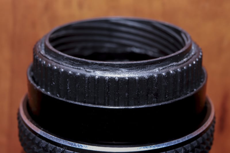

All I had to do now was to build an adapter to combine the two lenses. An old lens cap and the original thread of the Canon lens were sufficient material:
The former front element of a Canon 28-80mm zoom lens; it comes in a thread, which makes it easier to adapt.
The original thread for the Canon front element, adapted to a 24mm base lens.
This combination worked beautifully. The magnification ratio and the focal length seemed about right with good sharpness. Plus, unlike its predecessor, it fits into any camera bag. So I took it out for some test shots:
And I was happy—the lens had a super-wide focal length of 17mm with some minor vignetting. But the best part was the image quality, which was the best I had seen since I started this project.
Its aperture ranges from f/2.8 – f/22 and it focuses from 21mm all the way down to 0mm. This is quite a short range and the lens’ major downside: it can’t focus on infinity. In the future I might add a helicoid to this lens to enable infinity focus…

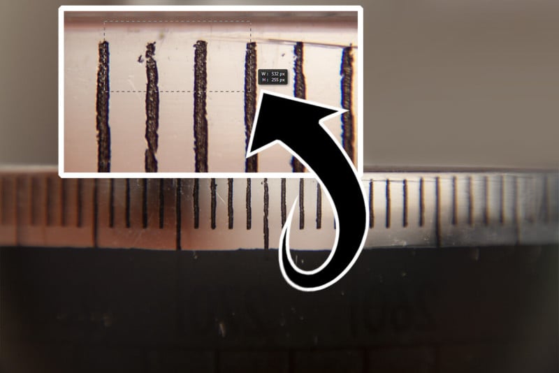

To measure the magnification factor of the lens, I photographed a ruler while focused at 2mm (closest workable distance). Next, I selected the center three millimeters in the photo in Photoshop; the selection measured 532 pixels.
This means, that one millimeter measures 144px in my photograph. Dividing the 5616px width of the camera sensor by 35mm shows that one millimeter of the sensor holds 147px.
Finally we need to determine the ratio between photograph and life size: 144/147 = 0.98 ≈ 1x

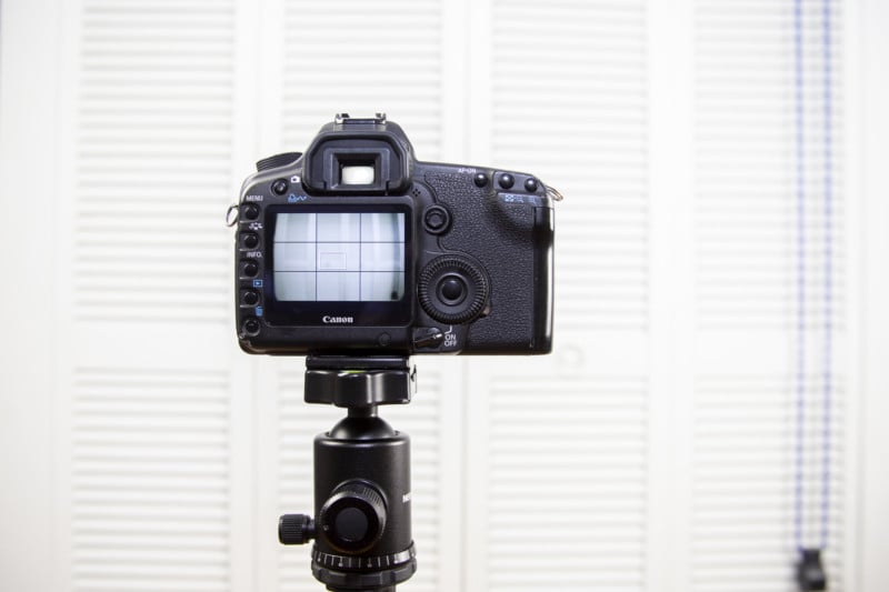

Measuring the viewing angle
Next I needed to measure the viewing angle—a simple task at last. All I had to do was to fill the frame with a background, mark the background at the edge of the frame and then measure the angle between the marking and the orientation of the lens (measuring from its very center).
I used a closet for the background and filled the frame with 4 of its panels—this way I didn’t have to use markings, I could measure straight from the center of the lens to the edges of the closet:

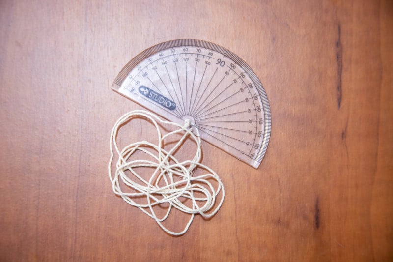

To measure the angle, I used the homemade device in the image above. By holding the plastic disc right to the front of the lens (perfectly parallel to the sensor plane) and the other end of the string to the corner of the closet, I can determine the viewing angle.
In this example, the scale showed and angle of 43° on the one side and 137° on the other. To finally determine the angle of view we have to calculate the difference between these numbers. The result is 94, which equals a focal length on 17mm.

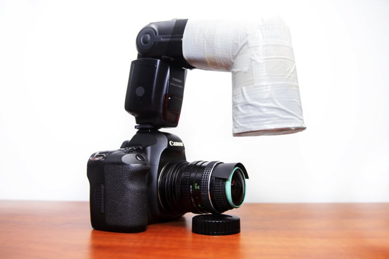

This image was shot at a working distance of about 5-6mm with a traditional shoot-through diffuser. Even though already optimized in orientation and position, it doesn’t yield a lot of light on the right side of the frame, where lens was just too close to the subject.
Another lighting solution that can work well (given the right circumstances) is a simple DIY diffuser made from a can of chips. You find more information on DIY diffusers and how to build one here.
This modifier creates the good lighting for most subjects. In many scenarios fill light will be reflected back up from surfaces underneath, such as leaves or the ground. Notice the little piece of black paper: that is my lens hood. Without this, the flash would cause too much flaring in the images.

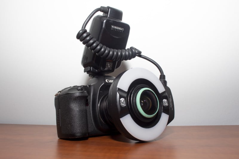

The “ideal” light source to choose really depends a lot on the specific situation, but generally a ring flash will be the best and most universal solution.
A dedicated macro ring-flash fits around the the front element of the lens and supplies light from all directions. This definitely helps with the lack of light, but also adds to the size of the lens. At short working distances this can get in the way when there is limited room.

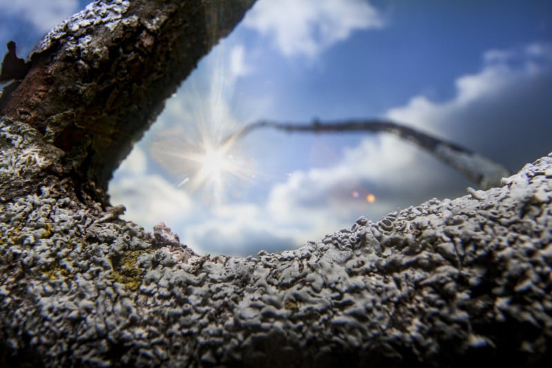

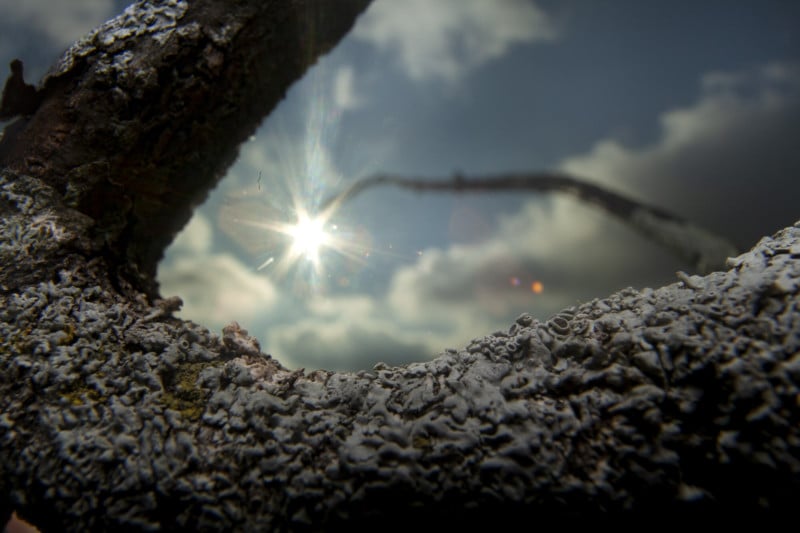

When shooting directly into the sun, however, the contrast suffers and chromatic aberration increases drastically. The sharpness/contrast remains good as long is the sun is partially hidden behind a subject and/or off-center.
Photographing directly into the sunlight creates eye-catching sunbursts and doesn’t take away too much of the image quality, as long as you partially hide the sun or keep it out of the center of the frame.
1/80th sec, f/9.0, ISO 400, macro-ring-flash (underexposed)
These sun-bursts look great in silhouette shots; the wide image angle adds enough context and the sun-flare creates an interesting splash of colour.
1/80th sec, f/9.0, ISO 400, ambient light

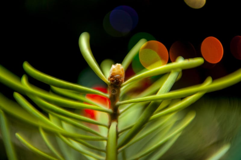

Bokeh
The background blur of the lens, or its bokeh, is soft and soapy when wide open. It renders specular highlights nicely and with a bit of a swirl, a look many old Russian lenses are known for.
The tip of a Christmas tree branch with twinkle lights in the background.
