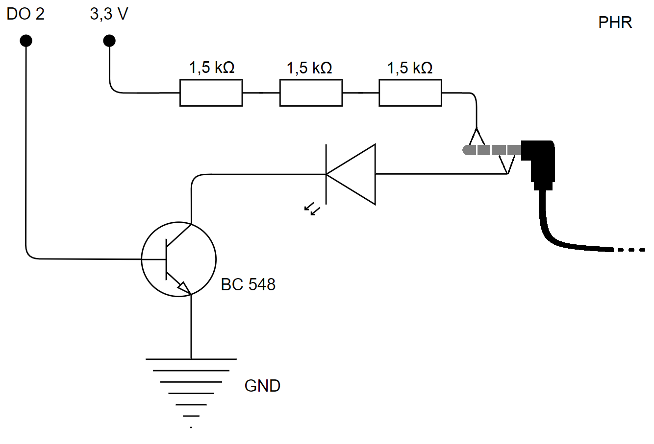

To trigger the camera, I didn’t want to use the internal interval timer, because it would stop after 999 pictures, so I decided to use an Arduino board. The code I wrote for the Arduino worked by shorting the contacts of a trigger cable (connected by alligator clips) by setting a digital output pin to “high” at a given time interval. Each time it triggered a short, the camera and flash would fire.
As a power source for the Arduino, I used an old laptop that was constantly plugged in. This didn’t just provide power, it also meant I could update the code on the fly, if need be, without moving anything around.

Figure 2: Circuit diagram of the trigger mechanism on the Arduino.

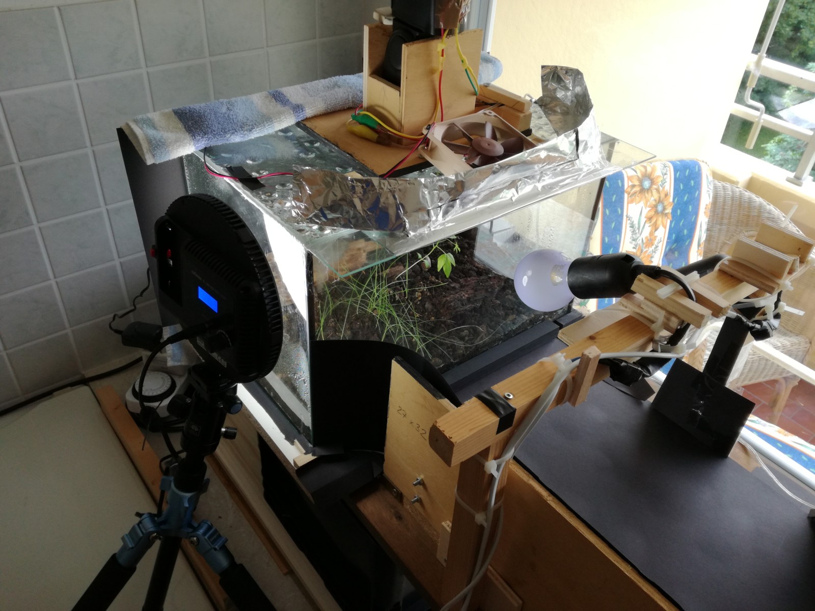

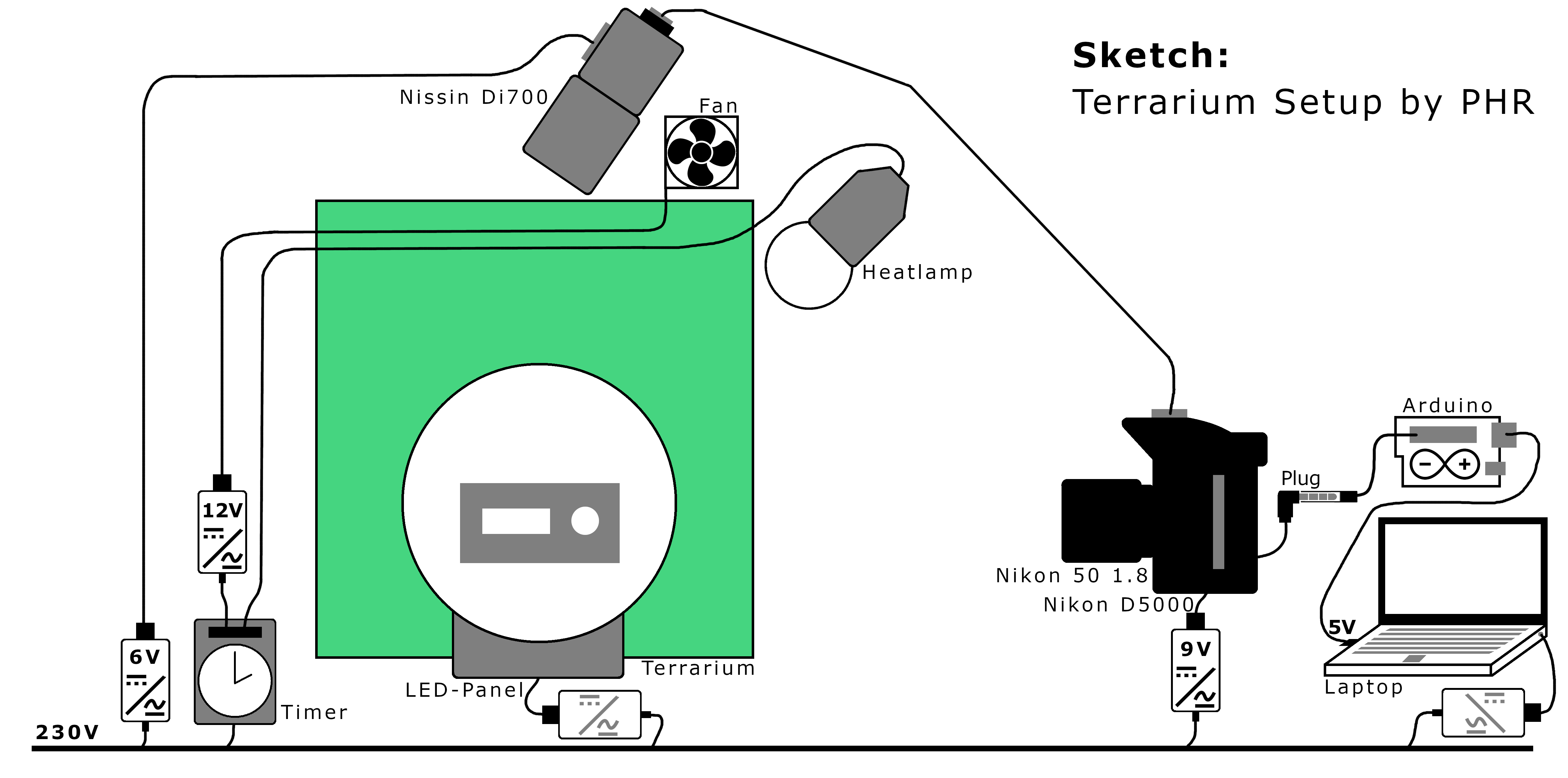

I built a practical setup out of spare wood to hold the terrarium and the camera in the same relative position to each other for the whole time, and coated parts of it black to cut down on reflections.
I screwed the camera to a block of wood with a standard tripod screw and then glued the wood to a base plate (no glue on the camera). I also built a holder so that the flash was always in the same position on top of the terrarium, and painted it black as well.
Because the evaporated water could not escape from the terrarium, a layer of haze was building up on the glass, which softened the image until, at some point, one couldn’t see anything anymore.
Using a hairdryer to warm the glass from the outside all the time proved to not be efficient and also quite disturbing… so I installed a heatlamp (like the one you would on a terrarium with reptiles inside) to warm up the glass, which turned on and off every 15 minutes in the time with the photos so that it was never on when a photo was taken.
Figure 3: Sketch of the whole setup.
Figure 4: The hourly plan for the timer.
Unfortunately, the glass on top also warmed up, and no water droplets were gathering or falling down any more. So I had to install a small fan from an old PC to cool the top glass, which finally worked to keep the ecosystem in balance.
