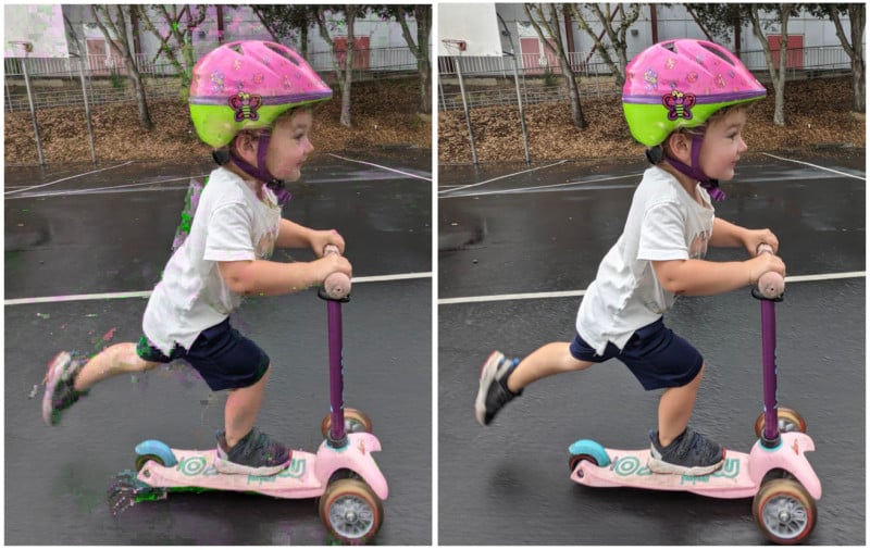

In regard to its merging process, the technology chooses “one of the short frames as the reference frame to avoid potentially clipped highlights and motion blur” with all other frames “aligned to this frame before they are merged.” This method has a disadvantage whereby ghosting artifacts, caused by motion, can occur. To reduce this, Google claims it has designed “a new spatial merge algorithm, similar to the one used for Super Res Zoom, that decides per pixel whether image content should be merged or not.”
Left: Ghosting artifacts are visible around the silhouette of a moving person when deghosting is disabled.
Right: Robust merging produces a clean image. Image and caption by Google.
