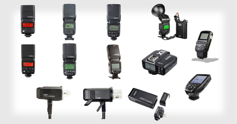

There are 3 transmitters for the Godox X Series. The XT32, X1-T, and XPro. All 3 offer manual control of off-camera groups.
The X1-T was the original trigger. It is TTL and HSS capable, offers control of up to 5 groups, and has a hot-shoe on top. This hot shoe can be used to integrate a non-Godox flash or use another Godox flash on camera while retaining access to 5 groups of flash off-camera.
The XT32 is an alternate trigger design and while the interface is a bit more user-friendly because of its wheel and slanted display, it does not communicate TTL and there is no hot shoe.
The XPro is the newest transmitter that marries the feature set of the X1-T and the improved design of the XT32. It has the largest display which is slanted, is TTL/HSS capable, has individual buttons for selecting a group, and adds a TCM feature for converting a TTL output to manual.
Transceivers
This part of the lineup gives new users the most trouble. Godox offers 7 lights that can be used both on or off camera. 6 of these are speedlights of various capabilities, and the outlier is the AD360ii which is essentially a mega-speedlight with a bare bulb rather than fresnel head.

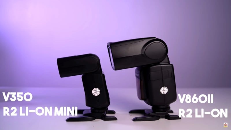

TT350 and V350: Mini speedlights that are designed to balance better with a smaller camera or mirrorless bodies. Both have TTL and HSS. The V350 uses a lithium-ion battery that lets it recycle faster and put out more flashes per charge, whereas the TT350 uses 2 AA batteries.
TT600 and V850II: Full-size speedlights with no TTL, and are only HSS capable when used off camera. Again, the TT600 uses AA batteries while the V850II uses a lithium-ion battery for faster recycle times.
TT685 and V860II: Full-size speedlights with TTL and HSS (on camera and off). AA batteries on the TT685, proprietary lithium-ion battery on the V860II.
One note, the TT600/TT685 can be used with an external power pack like the Godox PB960 to increase the recycle time. The V850II/V860II cannot.
AD360II: While it looks ridiculous on top of a camera, the AD360II can act as a speedlight and transmitter. More commonly it is used off-camera, as it has a small power pack. It’s a great portable OCF option as it draws 360w/s of power making it ideal for use on location.

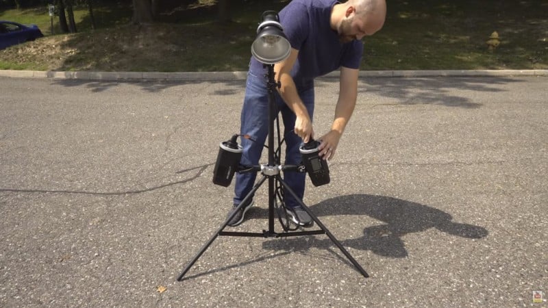

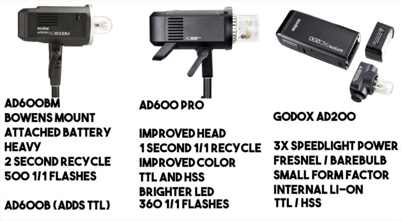

AD200: This was the most exciting flash product to come out of 2017. It is 200 w/s while maintaining a small size not much larger than an extended speedlight. It has an internal lithium ion battery capable of over 500 full power flashes and recycling its full output in 2 seconds. It has TTL and HSS and lets users choose between a 35mm fixed fresnel head or bare bulb. Adding to its flexibility, two packs can be mounted to one AD-B2 accessory creating a single 400w/s light source. There’s also an EC-200 remote head option for mounting the body lower on a light stand.
AD600B/AD600BM: This is Godox’s most powerful off-camera light. Both models are 600 w/s and use an attached Li-on battery. While they both are HSS capable the AD600BM does not have TTL (the M stands for manual). Both have a Bowens mount for light modifiers. Popular accessories for the AD600 include an AC adapter that replaces the battery for endless power, and the H600B and H1200B remote heads. The H600B offers 9 feet of cable for keeping the large AD600 body low on a light stand, while the H1200B draws power from 2 cabled AD600’s that can be mounted lower.
AD600 Pro: Recently Godox added a new flagship light in the Godox AD600 Pro, which offers the same power as the original. However, it improved on the original by adding a color stable mode, changing the bulb to create more even light, a 4x more powerful LED modeling lamp, and cutting the recycle speed in half. The recycle speed reduction came at a price though, as the AD600 Pro’s battery is capable of 360 full power flashes, which is lower than the original AD600’s 500. An AC adapter is already available for the AD600 Pro and a remote head is expected soon.
