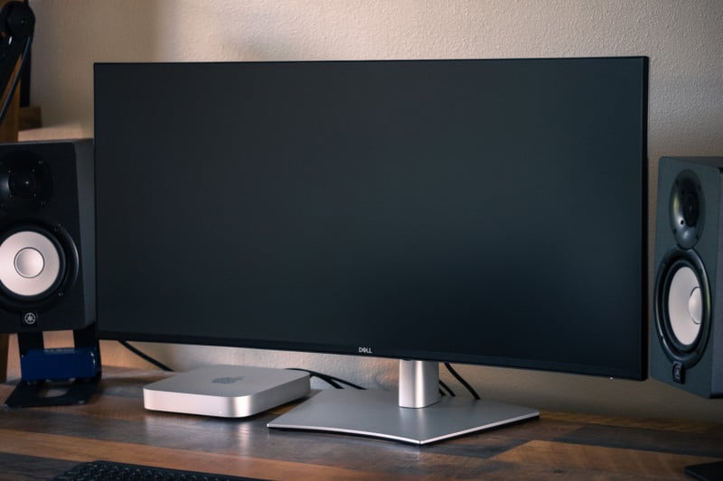

My first impression upon unboxing and setting up the Dell U4021QW was, ” I am overwhelmed.” I typically work off of one 32-inch or 27-inch 16:9 monitor (depending on what we’re currently reviewing at PetaPixel) and the switch to an ultra-wide was a bit staggering at first.
You can comfortably set up three windows side-by-side-by-side without anything feeling cramped. If you’re feeling especially masochistic, you could break the monitor into 6 sections and put a window in each — there really is enough resolution to accommodate it. But personally, it took me about a day of regular use before I filled up the entirety to do anything at all.
Setup was a breeze. The monitor “clicks in” to the stand while it’s still in the box, and then you use the stand to lift it out and set it on your desk. Ideally, you’d have a little help with this, because it is not a small monitor, but this easy-to-unbox setup is appreciated by those of us who live alone… or, in my case, with a dog who really wasn’t much help at all.
The stand itself is sturdy, with a reasonably small footprint and lots of positioning control. You can tilt, swivel, and adjust the height of the monitor with a single hand no problem, and the little hole for cable management is a nice touch. Bezels are minimal, about 0.4 inches (1cm), and the 2500R curve is just enough to eliminate any off-axis color shift at the edges when you’re sitting right in the middle of the screen.

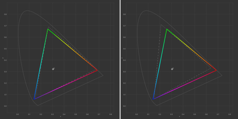

In our testing, the Dell U4021QW managed to cover 95% of DCI-P3 (left) and 88.5% of AdobeRGB (right).

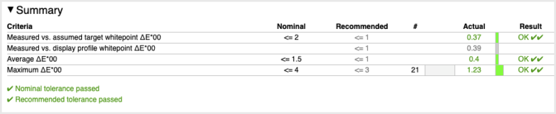

But first, let’s talk color accuracy and gamut coverage. While the Dell U4021QW does NOT have a built-in LUT or any support for hardware calibration, it does allow you to adjust the Gain and Offset of your RGB primaries, as well as the Hue and Saturation in six axes: Red, Green, Blue, Cyan, Yellow, and Magenta.
This turned out to be necessary because none of the presets were particularly good out of the box. In order to get my white point to D65, I had to switch the monitor to “Custom Color,” turn down the gain on the Green channel to 95% and give up a little bit of overall brightness. Once I did, the monitor performed admirably, clocking in 99.9% coverage of sRGB, 95% coverage of DCI-P3, and 88.5% coverage of AdobeRGB, at a Delta E 2000 of just 1.23.
That’s solid coverage at an excellent Delta E, but you’ll remember that Dell claims 98% DCI-P3 coverage, so it was a little bit disappointing to see the monitor fall short of the spec sheet. We’ve asked Dell why this might be, and will update the review if and when we hear back. Until then, we’ll just assume it’s a matter of variation from panel to panel. The colorimeter I used, an i1Display Pro Plus (that was recently rebranded…), is the same we’ve used to evaluate every other display reviewed on PetaPixel to date, so we have no reason to believe it’s gone wonky now.
Still, a few percentage points here or there are within a reasonable margin of error, and we were very happy with the monitor’s Delta E.
