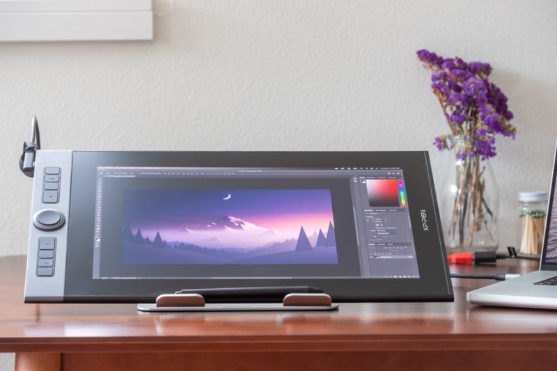

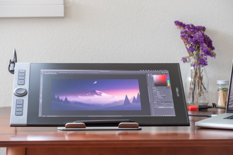

The new Artist Pro 16 is basically a rebranded Innovator 16: the “slim, swift, and sleek” 16-inch pen display that XP-Pen released in June of 2020. Obviously, the ultra-slim Innovator 16 struck a chord with buyers, and we’re glad that XP-Pen has decided to adopt the same approach with the Artist Pro series — both the design and built quality of the Innovator 16 are a huge step up from most entry-level pen displays.
The housing is solid metal with a “space gray” finish and measures just 1/4-inch thick. It’s solid, unlike so many of its entry-level competitors, which makes it that much more portable. I probably wouldn’t hesitate to throw this display in my backpack and take it on location.

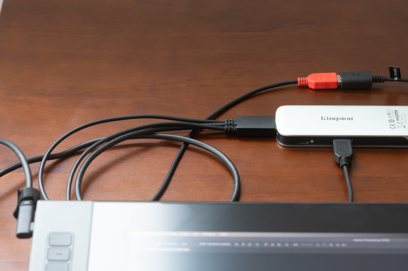

The only thing that would possibly hold me back from doing so is the clunky three-way cable that you have to use to actually connect and power the thing. A single USB-C connection on the display forks into an HDMI cable for display input, a USB Type-A cable for pen input, and another USB Type-A cable for power. The fact that there is no USB-C to USB-C single-cable solution is baffling to me, and one of the only major cons that hold this display back.

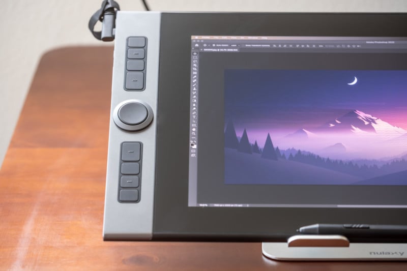

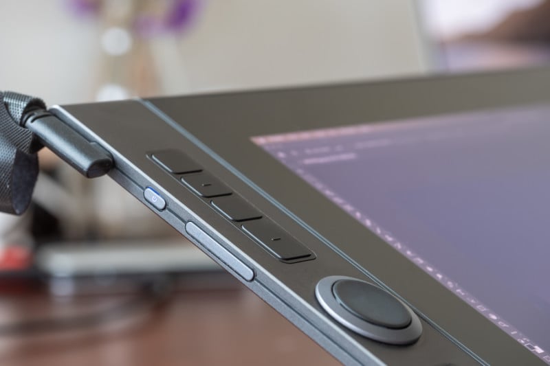

Customizability is excellent for a display this size. On the left-hand side of the screen is a row of eight programmable function keys and a mechanical dial, which itself surrounds a touch-sensitive surface that acts as a secondary dial.
I really like this design. The buttons feel great and the mechanical dial is my favorite way to adjust brush size, zoom in and out, or rotate the canvas, but I could have done without the touch dial. Because the mechanical dial is relatively small, my fat fingers accidentally activated the touch dial all the time, which eventually forced me to turn it off in the settings. I suppose it’s better to have the option, but at this small size, I found it more cumbersome than useful.
My only other complaint is that the mechanical dial has no “click” mechanism. It’s a smooth rotation, and I’d prefer some tactile feedback since the dial basically just presses “CTRL + +” or “CTRL + ]” when you’re zooming or adjusting brush size. Without any feedback, I often overshoot and have to adjust backward, since there’s a slight delay between the mechanical input and the digital output.
These are, of course, nitpicks. The very fact that it has a physical dial and eight programmable express keys already puts the Artist Pro 16 at the top of the heap. Its main competition either doesn’t have a dial or, in the case of Wacom’s current lineup of pen displays, no buttons whatsoever.

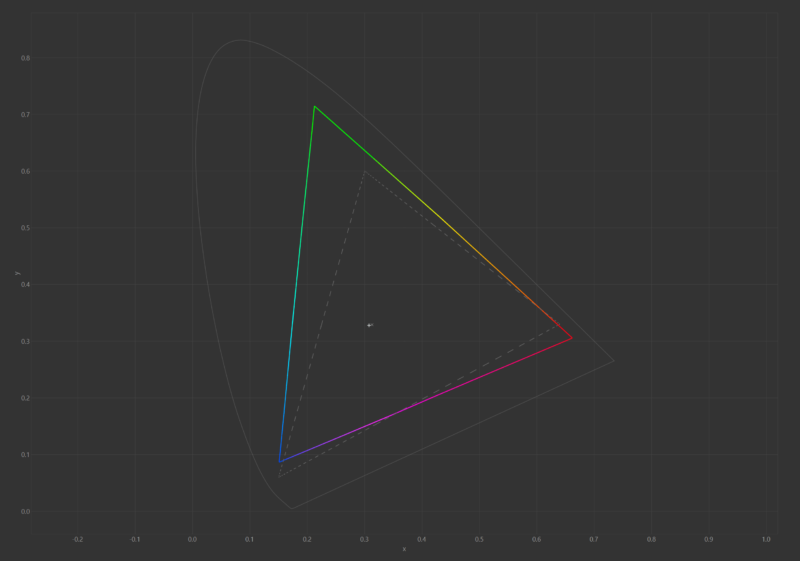

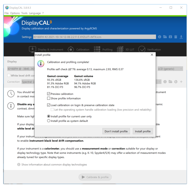

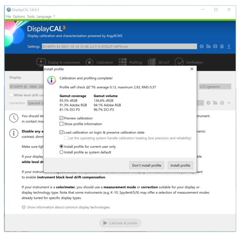

In our testing, the Artist Pro 16 was able to cover 93.3% sRGB, 91.3% Adobe RGB, and 81.1% DCI-P3 with a maximum Delta E of 2.93 and an average of just 0.13. That’s a great result, especially at such a low price, but you can see why XP-Pen decided to report gamut volume instead of gamut coverage.
When you look at the panel’s native gamut, you can see that the display’s blue primary isn’t saturated enough to show the most vibrant blues in the sRGB color space, even though it covers way more than sRGB elsewhere. That’s why it can’t quite hit 100% sRGB, not really:
The XP-Pen Artist Pro 16’s native panel gamut (colored outline) can’t quite cover all of sRGB (dotted line) in the blue region.
The other downside of this panel is the lack of control. You can only adjust brightness, so what you see is what you get when it comes to both color temperature and white point.
For our unit, the color temperature hovered around 6,675K and the white point was a bit off-balance towards the green. That balance gets better and better the lower we put the brightness, but I found anything less than 50 on the brightness scale was just too dim to comfortably use in a well-lit room.
For professional users, we would recommend picking one brightness setting, calibrating the display at that level, and then never touching this setting again. This will give you the best overall results. The display is more than accurate enough for web-based color-critical work in terms of Delta E, just be aware of its limitations in the blue region.

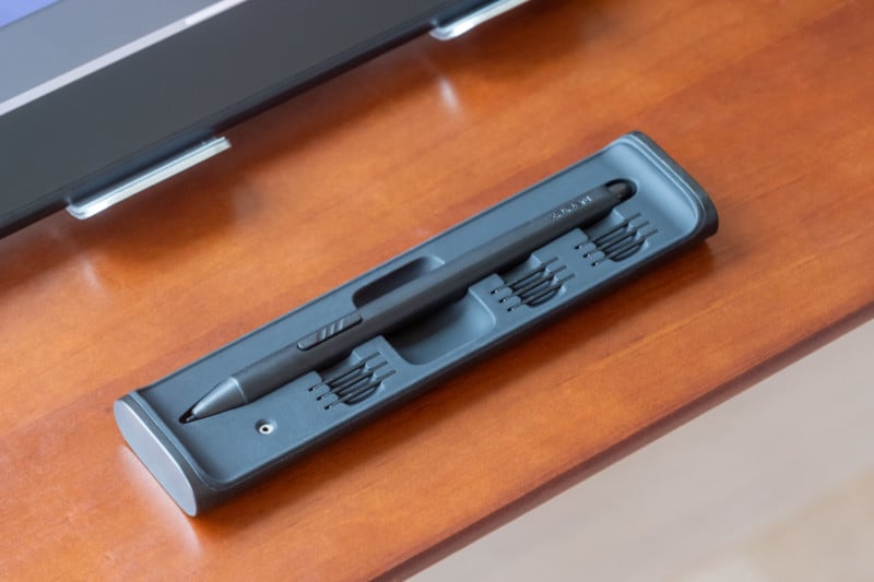

In addition to the slightly improved screen, the other new feature that sets the Artist Pro 16 apart from the Innovator 16 is XP-Pen’s new X3 “smartchip” stylus.
I’ll be honest with you, this upgrade alone is reason enough for me to go with the Artist Pro 16 over some of XP-Pen’s other options. XP-Pen’s other stylus is fine, but just like Wacom and Huion’s EMR pens, it’s kind of fat and uncomfortable for me to use. In contrast, the new X3 stylus is much thinner, sleeker, and feels a lot more like an Apple Pencil or the thin pen that comes with the Xencelabs pen tablet.
I find this form factor much more comfortable to use for long editing sessions, and XP-Pen claims that the X3 chip inside offers other benefits besides. Apparently, it produces a 10-fold decrease in initial activation force, bringing the IAF of this pen down to just 3 grams, and XP-Pen claims the chip is also more resistant to electromagnetic interference.
That second bit is actually interesting to me, as my standing desk mechanism has occasionally sent the cursor flying while I’ve been using some cheaper pen tablets. It’s a niche problem to be sure, but anything that makes the pen more reliable is a bonus in my book.
In terms of real-world use, I honestly didn’t notice a huge difference between this pen and any other pen display I’ve used. I’m sure if I had them side-by-side I’d notice some minor improvement in IAF, but for me, the biggest reason to praise the X3 smartchip pen is simply the improvement in form factor and reliability.
