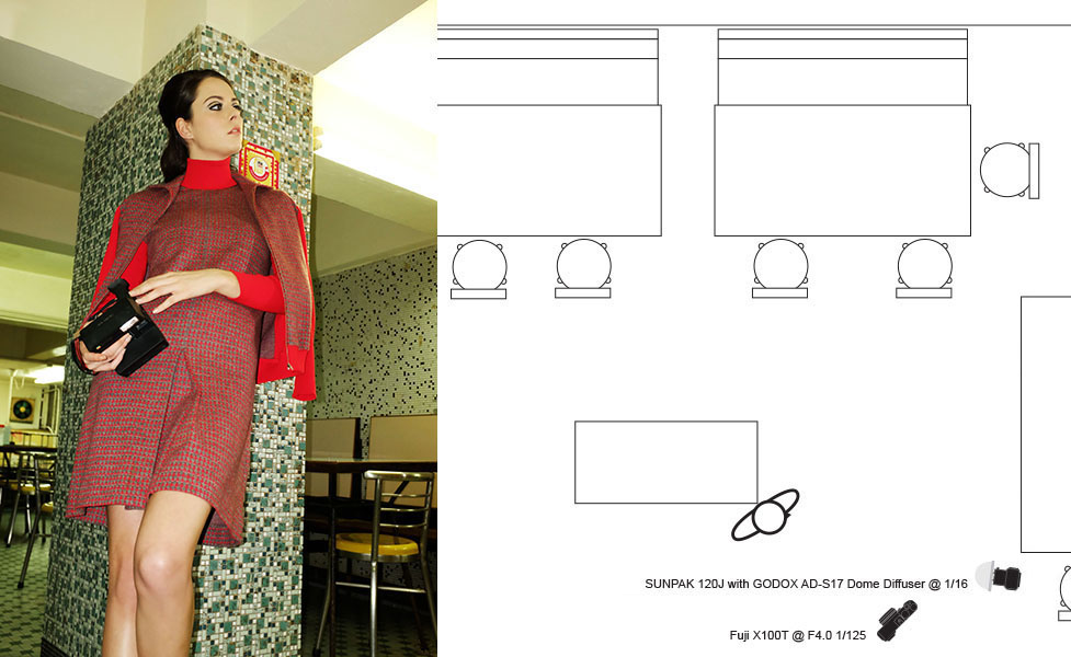

Below is the light setup with 120J for 1st wardrobe, my original idea is to use the 120J dome as a background ambient fill and the LEDs as a punch light to lit the face. However I quickly realized this is not possible due to the fact that a 120J with its lowest power is still way too powerful compared to the LEDs. After a few frames I decided I would just use one light (Flash). Now you will notice the over blown up corner at top left. It is so because I was shooting at ISO 3200, I wanted the background to be visible and the feel I go for is sort of a mid (50%) key exposure. So I shot a few test shots without flash to see at what ISO and shutter speed in order to get the background ambient exposure I wanted. After adding flash back in, I noticed the blown out corner but I let it go as the background was more important to me. The 120J lit images is sort of okay I guess, I can still tweak the 120J by shifting it more to the side and pull back further... I decided to switch to LEDs and see what I can get.
Model is Alexandra (or Alex in short as I called her) This is the first time I worked with an agency model so I was not sure what to expect and was a bit nervous. However the uncertainty quickly faded away when she showed up. Alex is focused and very independent. She is also professional and experience as a model. She arrived early, worked with MUA/Stylist Agnes on wardrobe and gave honest and good feedback when we discussed about the brief. She really knows her stuff. When we talked about the time constraint and the targeted 7 wardrobe changes within 90 mins, both Alex and Agnes expressed their concerns and suggested we do less wardrobe so as to have a better chance in getting good images. I explained to them why, and show them the mood board, the ideas, editorial story line on my ipad and macbook pro. Now I am going side track a bit. Communication is extremely important when you do personal shoot and when you are working with models, mua and stylist as a team. Respect and listen to everyone's point of views and try to work out something, be as clear as possible, if you do not have any references images, then draw it out. I assured them that I would assess the situation and decide while the shoot was ongoing. We reached the location early, had a quick bite and the owner graciously let us have a 15mins extra head-start. When the shoot started, I slowly got blown away by Alex - she warmed up very fast and took art direction well. She adapted and emoted so brilliantly that after 8-9 mins I decided I have also warmed up and proceeded with the actual shoot. I actually allocated 25mins for 1st wardrobe. 10-15mins for warm-up and then 10 mins to get the shot. We completed the 1st wardrobe including warm-up within 15mins. When it came to changing/re-style/touch up, both Alex and Agnes also amazingly did it at a impressive pace- on average 3-5mins. Both Alex and Agnes worked so fast and efficient that we went through 8 changes with 7 wardrobes. In fact we had extra time to repeat one of the wardrobes to shoot another idea I had. In the end we overshot the time by only 5mins.
Alex is truly awesome and I am totally impressed by what she delivered.​
Setup with LEDs, the result is more pleasing and close to the overall feel/exposure I wanted. The top right is still a tad blown up but I am cool with it. I have to push the LEDs much closer to Alex to lit her as compared to 120J dome which bounced light everywhere. The rim from model's left face and cheek is from the ceiling lights which give it more dimension, a happy accident bonus. Now can the 120J get similar result? Definitely yes. My guess is I would use a 120x80 softbox with grids and no diffuser. The larger size means that I can pull way back and a bit to the side to reduce the flash to better match the ambient background and give Alex a bit more shadows and highlight. The rectangle modifier also would allow me to move the light closer to wall, pillar or table if required.

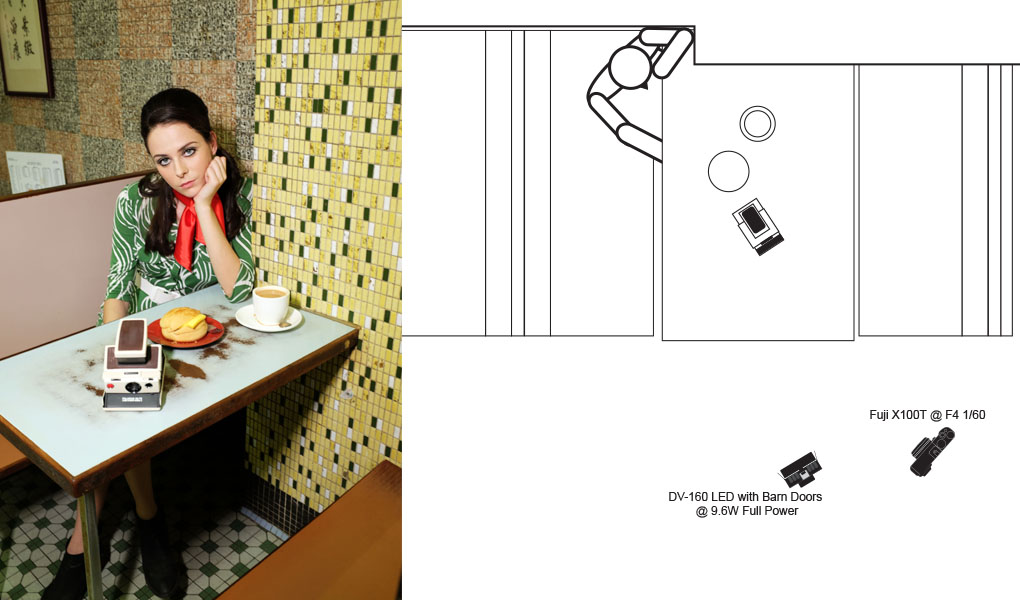

Hi all, just to share a quick setup for wardrobe #02. This was actually shot with LED video lights. I did try the flash when I shifted to another spot but the images was a bit "meh..." + the scene just did not work out for me. So I reverted back to LED, moved to this new spot, shot a few frames and decided to proceed to wardrobe #03.
Now would I be able to achieve something similar if I were to use SUNPAK 120J? Yes of course. Not 100% identical, but it should be close with a bit of chimping and tweaking with the light and camera setting. If I were using 120J, the Godox AD-S17 dome diffuser definitely will not work. Instead I will use a 60x90 rectangle softbox with grid. Reason? For me the size and shape allow me to maneuver more easily in small tight spaces. The softbox grid will also constrict the light just like the barn doors on the LED although the latter has the benefit of fine tuning the light spread easily.

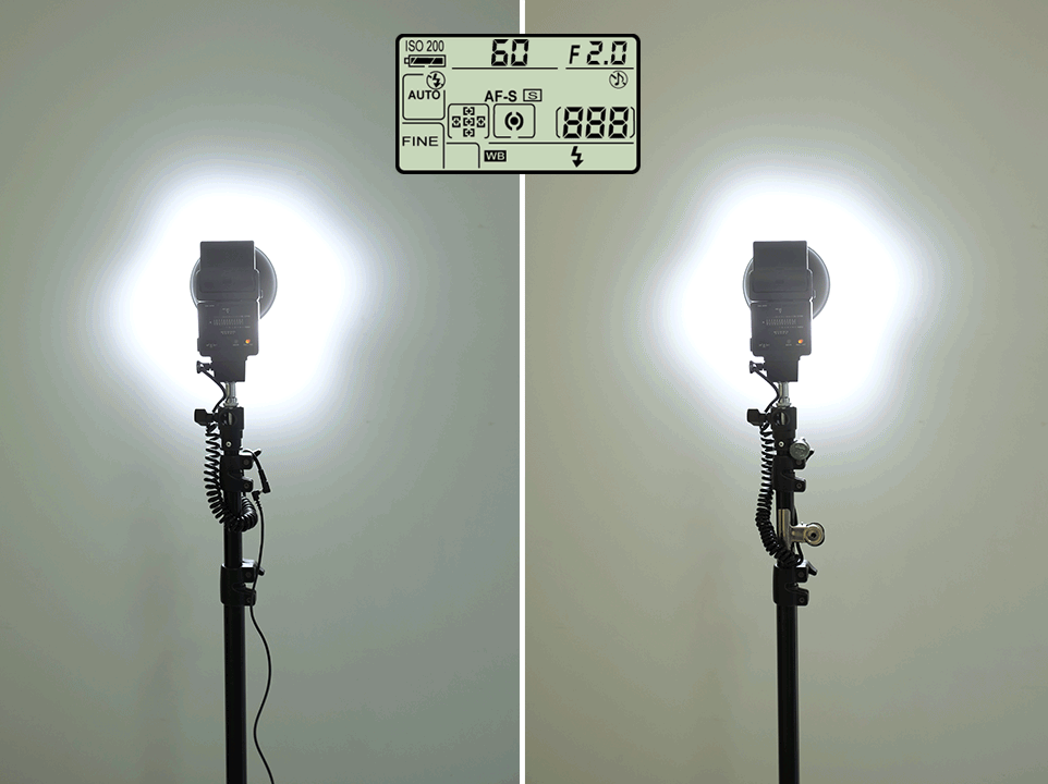

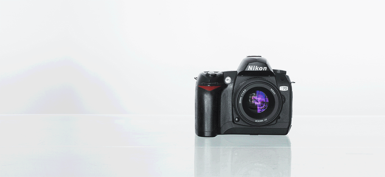

Let's get one thing right before I start - I really adore my Nikon D70. Yes, it is a 6 mega pixels 2004 DSLR, a great, great grandfather of Nikon D7200. The Nikon D70/70s/D40/D1 series have something special - they all use electronic shutters. Lets put all the quirks and cons of electronic shutter aside and discuss one of the biggest advantages they still have over all the "non electronic shutter DSLR" till this day. It can sync flash passed 1/500 to 1/1000 (using radio), 1/500 to 1/4000 (using PC sync/IR/Optic). Now I know High Speed Sync (HSS) can achieve something similar, and the tech has made improvements over the years. Cheaper HSS flash options from Yongnuo and Godox also let people own it without spending a fortune.
Although I am no expert when come to HSS, I do know that an electronic shutter camera has one advantage over it. HSS is a highly complex process that requires dedicated devices. That means a Profoto B1 HSS can only work with its Profoto B1 trigger (FYI, i don't know about B1, maybe it can work with other HSS devices). For my Nikon D70 I have no such problem. I can use my cheap PT-04/08, or any Pocket Wizard to trigger "almost any" flash at 1/1000. And if for some reason the radio trigger is not working due to external interference, I can switch to PC sync or IR to achieve even faster flash sync speed. Although I love my D70, sad to say its old age has caught up recently. The grip is getting sticky and the CF card slot sometimes is not so responsive during shoot where occasionally it gives an "err" message. The 6 mega pixels is also a bit limiting at times... my iPhone 5 can produce a 8 mega pixels photo. So last year I decided that I will replace my Nikon D70. After the disappointing purchase of Samsung EX-2F, I am more careful in picking what new camera I should buy. I shortlisted Fuji X100T, X70 and Panasonic LX100. In the end X100T was the winner. To double confirm my decision, I rented the X100T and went Hong Kong and did a photo shoot. It did not disappoint me. Now why did I not aim for the newer X100F? Actually I did consider, but when I went Hong Kong during late February this year, the X100F is still not released yet and the price is about S$500 more, as compared to a new X100T. And due to budget, I decided to go with a new X100T.
Now how well did the new kid X100T fair against the old grandpa D70 using the PCsync, which the Nikon D70 hit the insane 1/8000 (sort of).
It faired very well as you can see, sync effortlessly side by side with the old timer D70 all the way up to 1/4000. Now the X100T has an electronic shutter that can go up to 1/32 000. Why Fuji put a brake* and limit the flash sync at 1/4000 and not faster? I have no idea, maybe it is a hardware/science physic limit thingy? However the D70 has no brake limit set inside its firmware and it went pass the 1/4000 and hit 1/8000 (the fastest it can go), it did catch the flash but the image sort of got "burn"? I know when I pushed the D70 passed 1/4000, the image's color tends to shift but not this bad with "burn" and "corrupt" image effect? Signs of an old worn out sensor going to retire?
(*when you switch to electronic shutter, it will disable all flash options)

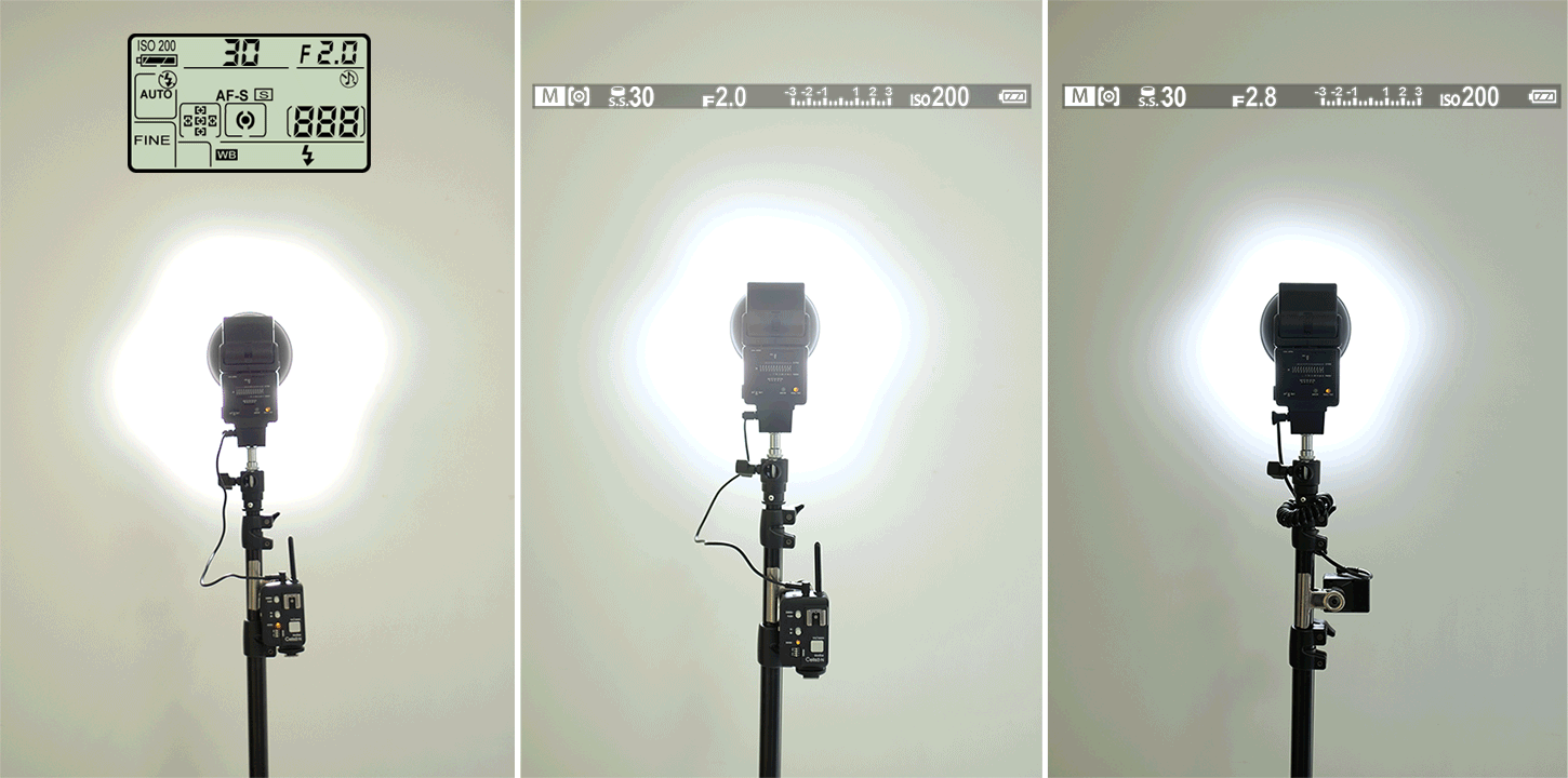

How about radio flash trigger, where D70 sync fastest @ 1/1250?
(From Left 1st and 2nd, Godox FT-16 triggered a Godox Cell II. 3rd image, PT-08 triggered a PT-04 receiver)
This is surprising! The X100T outperformed the D70 when it came to radio trigger. It sync passed 1/1250 all the way up to 1/2000. At F2.0 it did catch the flash @ 1/4000 although compared to PCsync @ 1/4000. It is significantly darker (radio frequency delay or leaf shutter limit?). Before I bought X100T, i did a lot of read up on the interweb. Based on what I read, the X100T can sync 1/1000 at all F stop. But to go beyond 1/1000, it needs to step down. You can read this from Mr Ken Rockwell review of X100T. 1/1000 all Fstop, 1/2000 from F4 and 1/4000 from F8. I manage to sync 1/2000 @ F2.0 and F2.8 (although the later black out @ 1/4000). More testings are needed, so I can get to know more about X100T limits.
So conclusion? Is the X100T a replacement for my beloved D70?
The answer is yes and no... X100T is a totally different camera from D70. It is well received and reviewed by many as a great street photography camera. The "flash sync speed" is just a happy accident due to the mechanical leaf shutter design on the X100.
What I like about the X100T
Mechanical Leaf Shutter - able to get fast flash sync at 1/2000-4000, 3-4 stops difference as compared to most non electronic shutter DSLR @ 1/250.
Compact size made it a great second camera for all types of shoot.
The optical and electronic viewfinder is refreshing and fun to use.
The Look - it is a damn handsome camera, I got to admit.
What I don't like about the X100T.
Fixed lens (it has options of mounting a wide or tele adapter lens, expensive though...)
Does not have Flash WB option like the Nikon D70. (Although it does have a "K" - Custom White Balance option)
Compact size makes it a bit slippery for big hands (I bought a hand grip + thumb grip just to feel safe handling it)
No dual card slots. (maybe it will have on Fuji X100V?)
Ultimately the X100T is a good but not the best replacement for my Nikon D70. Personally, as of now I don't think there is any camera that can entirely replace the Nikon D70. Maybe I should write a letter to Nikon? Hmmm... :think:

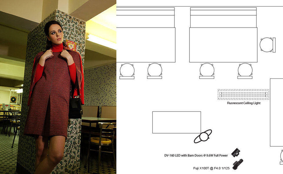

LED facing front slightly on the side, nothing complicated. Just to give a bit more light to the model's face without affecting the overall ambient environment.
Another photo that I like using the LED as main. Now if I were using 120J and I could move away all the tables and chairs, I would use a 60" reflect umbrella, roughly same position but much further away to fill up the background and add more artificial ambient to the scene. This would let me shoot at higher shutter speed to minimize camera shake. That's all everyone.

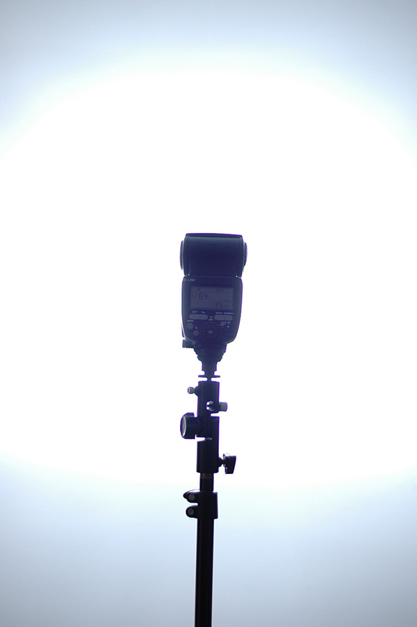

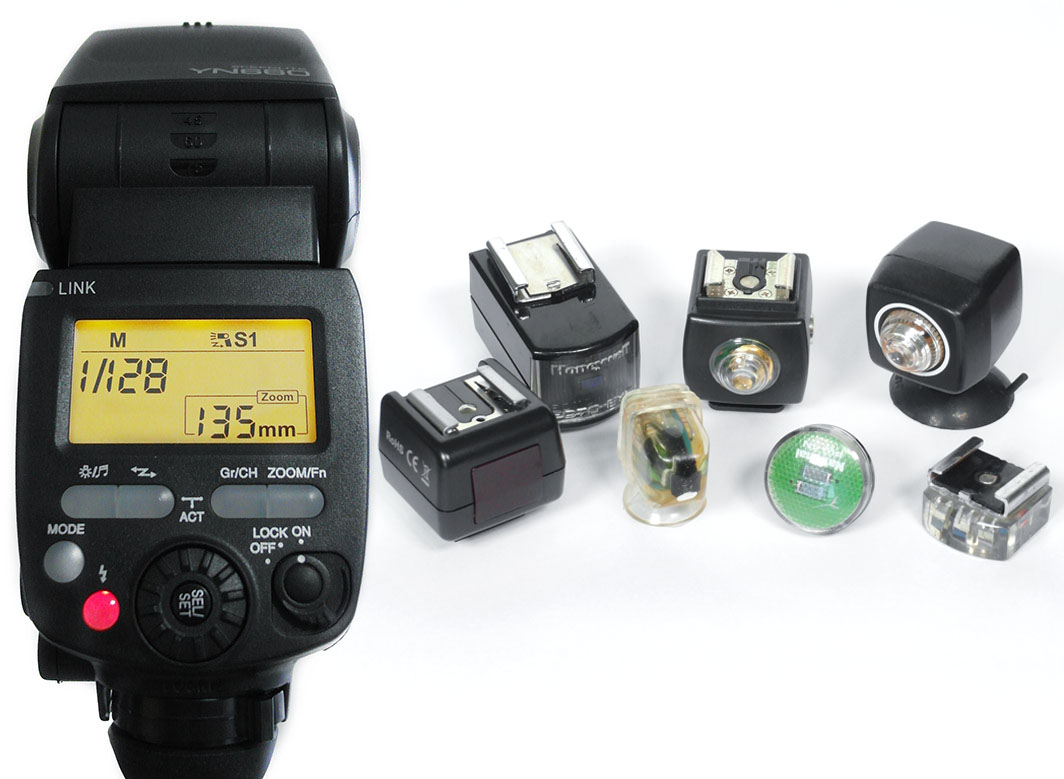

Hi all, today I am going to share another method in triggering camera flash or strobe, using Infra Light Flash Trigger.
Why use infra trigger, instead of your pop up camera flash? For me, there are 2 main reasons:
First, It won't affect your exposure, because we can't see it and so do our cameras (unless you modified it).
Second, it syncs faster than radio trigger. How fast? Lets find out and compare it to PC sync cable which syncs at an insane 1/8000 with Nikon D70.
It syncs effortlessly side by side with PC sync up to 1/4000sec. I forgot to take the 1/8000 test shoot as I was testing out my X100T a few weeks back. The X100T maxed out its flash sync at 1/4000.
Here is the 1/8000 test shot straight from camera, just resized and nothing else. The IR flash actually fired and it bounced off the white facing wall and triggered the Yongnuo flash's front facing IR slave sensor. Interestingly the EXIF data indicated that the flash was not fired? Not sure what happened... I will do more testing to confirm that in future.
As always there are pros and cons in every device.
Pros about IR Trigger
1. Sync flash up to 1/8000 (Nikon D70)
2. The IR flash will not add exposure to the photo.
3. Will work under water with the right waterproof gear.
4. Almost all optical/IR receiver do not need battery and relatively small in size.
5. Fairly affordable, easy to find online - used or brand new.
6. The IR flash will trigger "most" hot shoe camera flash/strobe with built-in slave mode.
There are many types and designs of IR receivers catered to different needs. Most mid to upper price range flash will also have built-in slave mode which will work with IR flash trigger.​
Cons about IR Trigger
1. Recycle flash time limitation. The Wein SSR recycles about 1sec but some consumer models may take 5-6secs.
2. Line of Sight, if the optical/IR receiver can't "see" the "IR flash", it won't fire.
3. May not work very well under strong ambient light condition (eg, Sunny noon outdoor)
3. Some IR receivers might misfire by external sources like a a flickering light bulb, thunder lighting or another nearby flash.
4. IR receiver (seldom though) may fail without warning due to component deterioration and aging.
5. Effective range is still slightly shorter than radio trigger, 8-10m for cheap IR models and 60-180m for pro IR models.
For me, if radio trigger is not able to work due to radio interference. I will choose IR flash trigger over PC sync cable when I am using more than 2 lights or I am in an environment where there are a lot of human traffic.

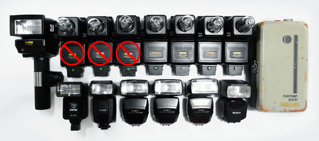

Happy New Year Everyone, 2018 has arrived.
Heads Up - this post will be my sharing of year end reflection with some gear and photography stuff ranting and what new things may happen in 2018.​
Last year I tried to do Polaroid Gal #07. The project was again (...I know, I know) put on hold when one important part of the plan did not go so well. I won't elaborate on what this part is, but is something I really wanted to try. Since it's my first try then, I think I will tweak my approach and try again. As my favorite movie quote goes - Never give up, never surrender!
2017 is definitely not a creative bleak year in terms of photography. I did do a few personal and paid photography projects which I gained interesting experience in term of transporting/handling gear and on location workflow. One of the personal shoots I did, instead of using flash and big modifiers, I used solely LED video lights. LED lights are really cool tools. They work well in small tight spaces and enable me to shoot much faster as compared to flash. Of course LED are not perfect. I have to shot at high ISO 800 and above because the light output is not strong enough and the LED lights are not ideal for long day shoot unless you are prepared to bring lots and lots of batteries. The shoot lasted about 6 hours - 4 hours into the shoot, all 5 LED lights chewed through all 15 NP-F550/750 batteries. In the end I had to charge and swapped the drained batteries continuously on the fly...not fun. Despite the few cons, the LED video lights will definitely still be an indispensable lighting tool inside my gear bag in the future.
I will also be looking into buying and trying new gear/accessories and possibly a new bare bulb flash beside 120J. Reason? After 8 years of using my 120Js, 3 of my 120J are out of commission 1 by 1 from mid to late 2017. I hope I can get them repaired but this did prompt me into looking for a 120J alternative as I am now only down to 4 set of 120J. Comparing to the availability of Bare Bulb Small Flash similar to 120J, I have much more options now than in year 2009 (back than only Quantum Qflash, great flash but super expensive) . The price of flash and strobe has also become more competitive when China makers like Godox, Phottix and etcs started making strobes. In addition I will also be sharing some cool accessories I bought last year that can be used with 120J in the strobist mini tips post.
The 3 set of 120J strangely all shared the same problem. The flash output adjust would not work and could only fired at 1/1 power.
Stay tuned for more strobist mini tips and sharing of new gears that I used together with the 120J​

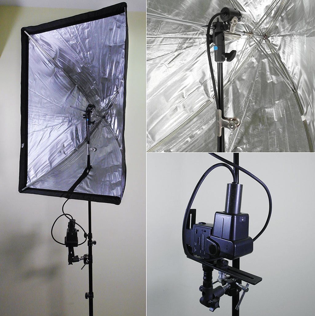

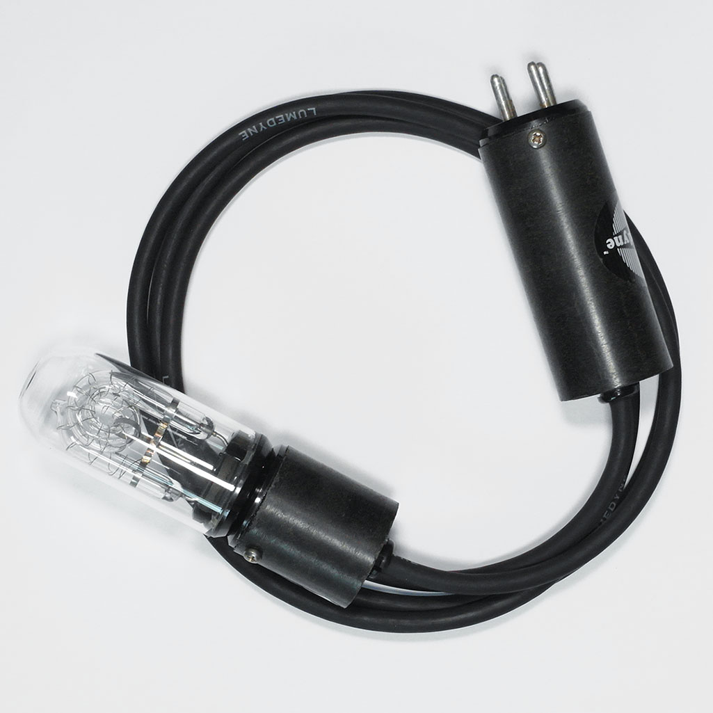

This mini tip is about a piece of strobe accessory that is not meant for SUNPAK 120J but it works perfectly. It is called the "Pencil Light". Why it is called the "Pencil Light" or "Light Stick" - I have no idea. I do know that the pencil light is designed for sticking in confined space or to conceal it from a scene to create an accent light or back-lit an object. However when I bought it, I have a different idea on how to use it.
I used softbox modifiers a lot. The SUNPAK 120J is not huge so sticking it inside a softbox is easy and it works well most of the time. However when I need to adjust the power setting, power off or change batteries. I need to un-velcro the softbox diffuser to access it. It takes less than 20 secs to do it so no big deal for me. However in some situation - an example where I am using a boom, accessing the 120J will take a longer time so this is where the pencil light come into the picture.
FYI, if you want to know how I usually mount my 120J inside the softbox, please check out mini tip #01 let there be light, thread #62.
By "separating" the 250W flashtube away from the 120J body, I now can access the 120J easily. It also lessens the load if the softbox is on a boom arm as now the 120J is not inside the softbox. Currently I have yet to use the pencil light in any of the shoots as I need to figure out a good way to mount the 120J and the flashtube attached to the pencil light. Stay tune for an update - I will share more in the future.
The Lumedyne Pencil Light is simple. It is just an "extension cord" made for flash. The cord length is about 1.45meter-ish. It is sufficient for most lighting scenarios, except if I was using a boom arm way up like 2.5m or higher than 1.45m will be too short.

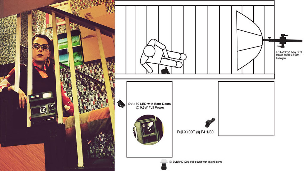

Now, back to another light setup for Wardrobe 6. This was a quick shoot as I already knew what I wanted for this scene. Below is the first shot with Alex sitting on the stairs. I was shooting from the bottom of the stairs with one hand holding X100T and the other hand gripping the LEDs mounted on a light stand lighting Alex's right side. Originally for lighting, I wanted a flash to hit the stair's baluster to create shadows on model and a boom light high up as main to mimic a ceiling light. Lacking time and necessary grip gears, I had to lit simple on the fly.
I took one shot of Alex with a confident pose. Then I directed her to give me this pose which she did brilliantly. I chimped on my screen, it's okay... I sort of like it but.. the shoes sort of didn't match with the wardrobe. This was totally my bad. For a personal shoot, shoes are just one thing very hard to tackle due to budget, right shoe size and matching genre. Alex did brought 3 pairs of shoes - one was a really cool pair of long boots which will match perfectly with one of the wardrobes, and the remaining 2 pairs were a pair of black heel and a light color platform (both were a tad bit modern). Since I was not feeling it for this shot, I decided to let it go and move on to another angle. Btw, when I went back to hotel, I realized all the shots were not sharp. Most likely it was due to the fact that I was using one hand to shot. 1/60 with both hands should be okay most of the time because X100T used a leaf shutter. Lesson learnt: I should have shifted to ISO3200 to get 1/125.
FYI: You can actually see the LEDs reflected at the front finder of the Polaroid 600​
For this shot Alex just moved down a few flight of stairs and I asked her to give me a similar pose like the one above. I got her to tilt her head to face away from the camera. Then I saw the reflected light from the nearby ceiling fluorescent tube on the glasses. Now I could ask her to totally face away from the ceiling light but it lost the impact or I could have taken the glasses and removed the plastic lenses so it would not reflect any light source. Instead I decided to have Alex to tilt her head slowly to find a spot where the reflected light did not block the pupils. And when I saw 'this' I told Alex to stop and took 'this' photo. I took 2 shots, chimped and said to Alex. "I got the shot. Great Job Alex, next wardrobe."

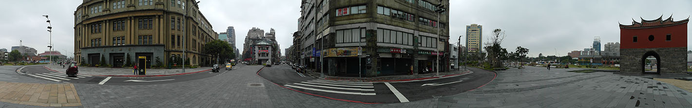

Panoramic view - standing at Taipei North Gate (ChengEn gate), the front entrance? to Taipei Camera Street.​

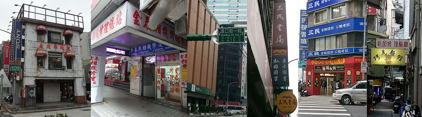

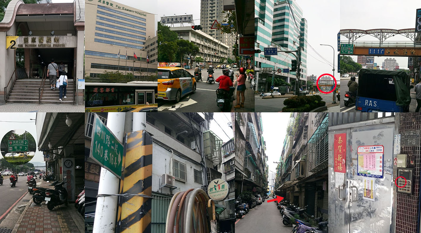

How to get to "尚品精修"
Despite that it is not located at the camera street, getting there is still fairly easy. I took a cab down from Bo'Ai road and it took about 20 mins to reach and the cab fare was about Twd 250+. My advice is not to take taxi as locating the small alley is hard and the traffic is very busy. Otherwise another good idea is to drop off at Sichuan Road upon turning into the 65 Expressway then walk along the row block buildings and locate the small alley on the right. If you decide to travel MRT, take the blue line from Taipei Main Station (BL12) and alight at Far Easter Hospital station (BL05), exit from the station's Exit/Entrance 2. Once you are out of Exit 2 you will see the Hospital facing opposite you. From Exit/Entrance 2, just walk straight down and you will see Oriental Institute of Technology. Keep on walking and you will this Sichuan building and not far away there is an overhead bridge. Walk towards this bridge and turn right into 65 expressway. Keep walking and you will see a small lane on the right - Lane 140, Section 2, Sichuan Road. There is a shop selling and repairing coffee makers at the alley entrance. Walk straight in turn left. Keep walking straight, "尚品" is on the right. Opposite "尚品" is a small car garage. Press the door bell and wait for "尚品" to remotely open the metal door for you.
Although my interactions with other Taipei camera repair shops were brief, my first impression for all was very pleasant.
全泰相機修理中心 - one of the oldest and well known camera repair shop in camera street. I had a chance to speak with the boss who is very knowledgeable and friendly. He has a cute pet dog wandering inside the shop. Can't repair 120J cause no new parts readily available.
二哥的店 - managed by 2 helpful young men. Will accept hot shoe flash repair provided if parts are readily available.
蘭陽相機維修中心 - hard to find... have 2 ways into the building? Only the entrance with a security mini desk leads to a lobby have lifts. I used the "back passage" no lifts only stairs? Had to climb 5 flights of stairs. The boss about mid 30s was friendly and chatty, quite intrigued about me using such an old flash. Able to repair hot shoe flash if parts are readily available.
雷虎相機修理 - Boss not in (usually come in after 1-2pm), Lady boss said they only repair modern camera flashes. She also told me they had many pending repair jobs and turn around time was 3-4 weeks.
When you visit Camera Street (Bo'Ai and Hankou Street), you may also consider dropping by "Book Street" along Chongqing South Road (about 80m next to Bo'Ai street). "Book Street" has shrunk very significantly in the number of shops since its golden era. But you still can find a few well known old book stores, for example San Min. I found that photography related Chinese books in San Min have a bit more selection and topics, as compared to the modern and popular Eslite Bookstore. And the pricing is very competitive as you can find a lot of local publications. If you like food, you can also try the famous pepper bun (instead of going to Raohe Street Night Market) which is also along Chongqing South Road. Btw I found this "Singapore Barber Shop" while I was wandering along the camera street - took a photo out of fun.

Godox AD200 is a really interesting and competent flash. Its advantages are:
-More power, 200Ws means that it is at least 1 1/3 stop more light, compared to the conventional hot shoe flashes (45Ws-75Ws)
-Able to change how the light emit using interchangeable head module depending on photographer's need. (similar to SUNPAK 622 Pro)
-Competitive price, @ S$375 (HK2150) is still much cheaper, compared to Nikon or Canon TTL flashes. Nikon SB-700 S$499, SB-5000 S$799 (omg!)
-Its compact size makes transport and storage easier for "one-man show" photographer.
-Built-in radio receiver to work with Godox radio triggers (*Note: some older models will not work)
-Lots of accessories like the AD-S18 (similar to Quantum bare bulb enhancer, which I used here), AD-L (A LED Light head module), EC200 (something like the "Pencil light" I talked about @ #148), AD-B2 (combined 2 AD200 to give more light) the new H200R (a round flash head module) and others.
Although Godox AD200 is almost perfect, all flashes will have some cons. As I don't own any AD200, I can only find 1 fault on AD200 based on paper. And this fault is the very reason why I am still on the fence on AD200 and decided to repair my 120Js.
The fault is - It can't be powered using AA batteries or other optional external power pack. Now before any Godox AD200 owners start to scream @ me, please hear me out. AD200 uses a 14.4V 2900mah Lithium-ion battery which can give 450-500 full power pops. With this kind of battery power, it is more than adequate to last from start to finish for most types of photo shoots. However when it comes to commercial photography, having a plan B is always important to me. Unpredictable situations always will lurk around despite how prepared the photographer is. Situations like lithium battery died on location or the charger having problems and can't be charge and etc. Of course this kind of problems can be solved by buying more spares. However what if AD200 and its batteries both were to be discontinued (eg, replaced by a new model). How long do you think AD200 can operate when the only proprietary power source is no longer available?
SUNPAK is a very old flash. How old I am not very sure. I do know that 120J TTL came out a bit earlier than 622 pro which started its sales during the late 80's. So 120J's design is at least 30+ years old. Despite being aged, its ability to use AA batteries and different external power sources* have made 120J more reliable when it comes to powering. Of course 120J is not a super flash which is unbreakable. Common failure problems are - the flash head has a tendency of breaking or losing its fiction locking from wear and tear or impact from drop, capacitors degradation (can be replaced) and circuit board degradation.
So when 3 of my old 120Js broke down. I decided to bring along the 120Js and was hopeful to get them repaired when I went Taipei last year. Fortunately I met Tsang Shifu who managed to repair all 3 flashes.
So why?
Reason #1
- 2 of these used 120Js have been with me since 2009 and been to many shoots. Feeling a bit sentimental, I felt sad to just throw away these flashes without trying to fix them.
Reason #2 - Despite lacking advance features, I think 120J to me is still currently the best "AA battery power" 100w+ bare bulb flash which serves my needs and requirement.
