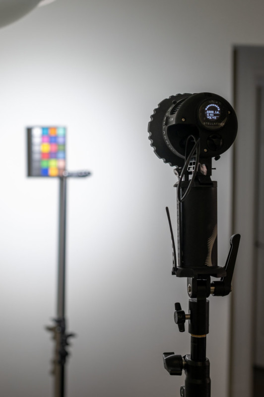

While the Reflex is not meant to be connected directly to a camera’s hot shoe mount, it is rather versatile in its design. The battery can be disconnected from the main light making it easy to swap and charge, and with the variety of connection points, it is possible to mount the light in multiple ways to light stands.

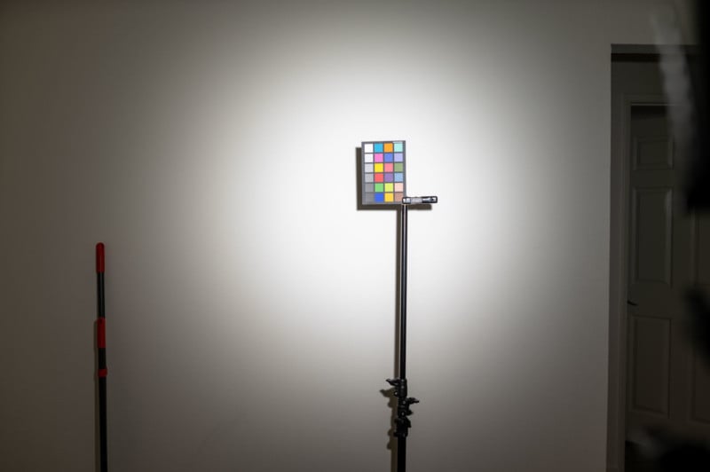

It is in a comparison of strobe power that things get interesting. While the Reflex system is quite useful for a hybrid shooter, it just does not have the power to compete with a Profoto A1X (or even a standard Godox speedlight) in terms of raw “pop” power. The Reflex uses a strobing LED while traditional speedlights still use a flash tube or bulb. During the course of my testing with the Reflex at max power, shooting a portrait at ISO 100, f/4 to 5.6, and a shutter speed of 1/160 (standard flash sync speed), I could get a pretty decent image out of it. However, keeping the same camera settings and using the Profoto A1X at full power returned results that could probably be seen coming from a mile away.

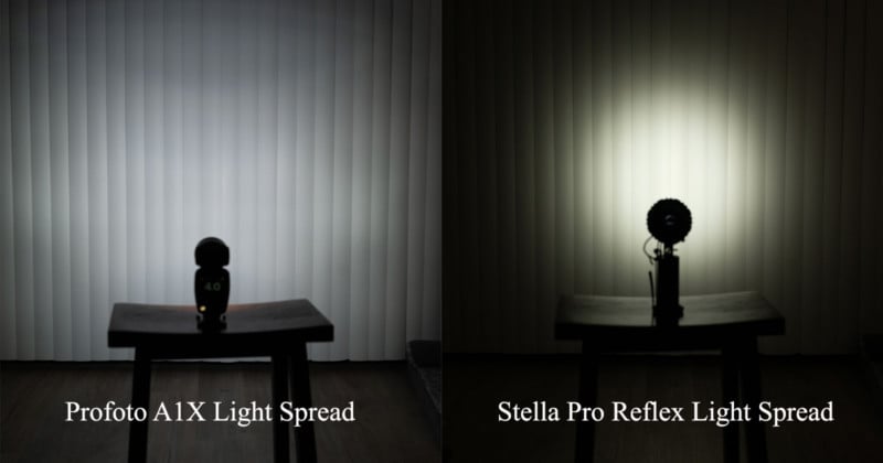

As you can see, the A1X is overwhelmingly brighter than the Reflex when it comes to its strobe power. But more than that, the light spread is significantly different between the two lights. With the Reflex system, regardless of the power level, the spread of light is very tight and contained, making it easy to control and adapt with modifiers.
The Profoto A1X has a much wider spread and it is also worth noting that the A1X has a slightly different tone (straight out of camera) when compared to the Reflex system. To get the A1X to provide the same spread as the Reflex would require adding a grid or two.
