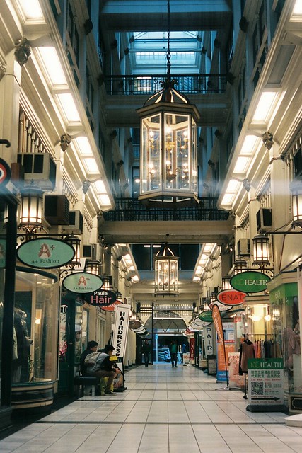

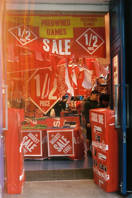

Hi all,
Would anyone here able to tell what's the problem that cause all this weird lines?
F1230037 by Victor Ng, on Flickr
F1230034 by Victor Ng, on Flickr
F1230029 by Victor Ng, on Flickr
F1230005 by Victor Ng, on Flickr
F1230019 by Victor Ng, on Flickr
It seems like those taken in indoor was better compared to outdoor.
I asked the local lab that processed the negative and the guy has no idea as well. This is his first time encountered such.
Could it be damage to the shutter? I am yet to check my camera since there's still a roll in it

Hi victor, it look like light leak to me, that explain the indoor photo better than outdoor. Check the door foam on the back of your camera, especially the top areas.
Thanks. Will need to quickly finish up the loaded film and check. Hopefully it's not big issue with the camera

which camera body you are using?
