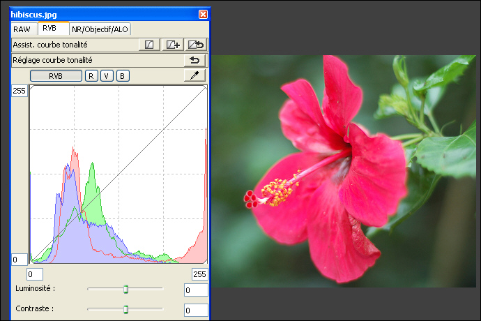

Yeah, but there are a couple of problems here.
First, contrary to the suggestion above, you can't have a histogram that "seems wrong". It's a visual representation of the data in the image. Either it's saturated, and you will see a spike/hump/peak/collection pegged at the right edge of the histogram, or it's not, and you won't see that. If the histogram is "wrong", then the machine (computer, software, camera, whatever) you're using to compute & show the histogram is wrong, and I'm pretty sure lightroom isn't broken. Is the implication that the histogram is being shown incorrectly in Nikon cameras?
Second, you can't use an image processing program to take an 8-bit jpg image that is "saturated" in and "unsaturate" it. The attached picture above, reduced in "exposure", isn't a helpful illustration.
An exercise to "reduce the exposure" on an 8-bit jpg that has areas of saturation (i.e. pixels in which one or more of the color channels has the value of 255), no matter the software you're using, will have no effect on the saturated areas. True, some of the pixels "near" the saturated pixels may not be totally saturated (i.e. slightly below 255), and when you "reduce the exposure" of the image those pixels will darken and you may think this means you're eliminating the saturation. But the saturated pixels, which will invariably be areas (collections of pixels), will all hold exactly the same value.
In other words, if you have an area of red saturation, that means you have an area with a group of pixels that have a value of 255 (in an 8-bit image) in the red channel, meaning you've lost all "detail" in that areas since no difference exists between one pixel and another. If you reduce the brightness/exposure of that image in 8-bit space, then that group of pixels will still have exactly the same value in the red channel, even though it may no longer be 255. Even though the saturated area of pixels may no longer be bright red, you'll still have a splotch with no detail (but with some other color).
By the way, the above applies no matter if you process the image is 16-bit space or 8-bit space, presuming you started with a jpg (8-bit by defnition). In other rods, you can't just load up an 8-bit jpg in photoshop, switch to 16-big mode, and expect to overcome this issue. You CAN start with a high-bit image (like RAW, which is generally 12-bit, or a 16-bit image) that appears saturated in 8-bit space, but which has not fully saturated in 12/16-bit space, and lower the exposure to eliminate the saturation at 8-bits. I'm at a loss to explain, but I hope the concept is clear.
The histogram included above clearly shows that the TS's issue is NOT saturation. He must be getting thrown off by either depth of field, proper focusing, camera shake, or something else. But it's clearly not saturated in the red channel, else the histogram would show the red channel shoved all the way to the right.
TS, try it yourself - increase the brightness/exposure until you SEE the histogram shove up to the right side. That's what saturation looks like. If that doesn't look like what you're worried about, then consider other factors.

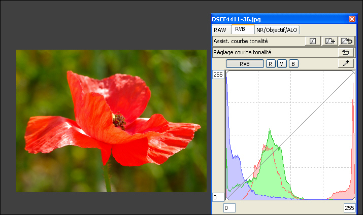

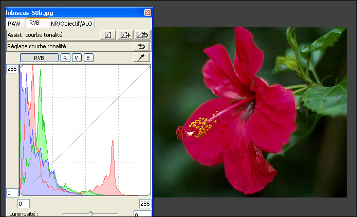

I just pointed out the picture is overexposed : because it is.
If you don't want the picture to be overexposed, you have to take care of the red color channel when picturing red subjects :
In such case, i'm not fan of post-production corrections. The very simple solution is to have in mind you can easily overexpose red subjects even if your histogram seems normal and well-centered, and to expose carefully on the field for red color channel before snapping.
Please do note that whatever post processing you are doing to that hibiscus flower, it ain't what is suppose to look like.
Yeah, except that the histogram the TS posted does NOT show the red channel saturated. Maybe he's saturating it in his post. But the adjustment you've posted results in an image that has shifted from having saturated red in the flower, to saturated, darker red (magenta?) in the flower. You can't fix a saturated 8-bit image in post.
Maybe we're saying the same thing. As you very correctly point out, you should, particularly with flowers, expose carefully in the field for the predominant color/tone.

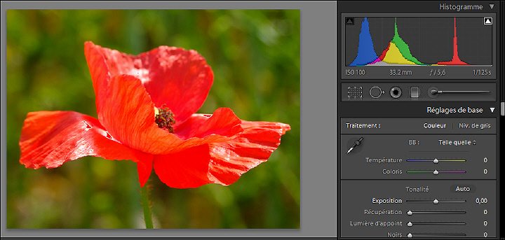

I beg your pardon as i insist. The histogram the TS posted seemed normal but it is not true. I have been trapped myself many times before i understand why. RGB histogram appearence captured in Lightroom fools us, just as white histogram can do.
If you take TS's picture or my red poppy picture, and open them in Lightroom : everything may look OK. But just try, open them in other software : the red color channel is no doubt against the right side, it's to say satured. Photo are overexposed. It's very tricky, indeed.
I won't insist any more in this thread : just want to warn buddies and do my possible to help .
Wish all of you a pleasant further discussion,
YP.
I'm your youngest sister so i beg your pardon to insist. I don't want to have reason at any price. I just want to share my very small experience. The histogram the TS posted seemed normal but it is not true. I have been trapped myself many times before i understand why. RGB histogram appearence captured in Lightroom fools us, just as white histogram can do.
Have you discussed your question with the LR forum? It's not a direct feedback channel to Adobe but some developer are reading there as well and there are plenty of 'gurus' around. If the histogram is showing different information than another program it would be good to know why. Sometimes people use a different scale which can make a diagram look different although the input is the same.
