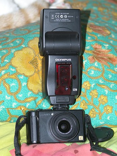

The LX-3 has full functionality with the Olympus FL-50R, other than wireless triggering.
I wish the wireless triggering works, even with the smaller FL-36R mounted it's awkward! But it does make people laugh when u walk around with the flash mounted on a compact :D
