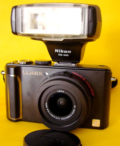

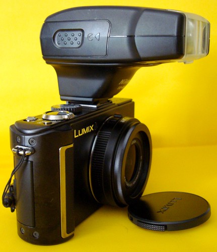

You can use the Nikon SB900 on the LX3, no go with SB400.
However, I don't see the point of using a SB900 with the LX3, I might as well bring my DSLR.
The Nikon SB400 will only work with Nikon cameras.
It's a good compact flash but unusable with the Panasonic LX3.
You sure have a collection of Nikon flash... :bsmilie:
A FL36 is a in between a SB99 & SB400..... :)
I'll have to say that the SB400 was a bad buy as I wanted to use it with my Ricoh GX100.
In the end, it only works with Nikon cameras.:cry:

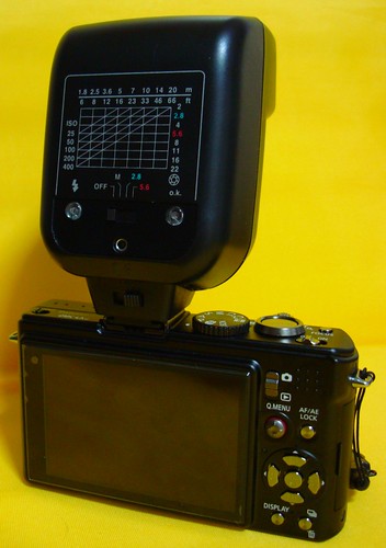

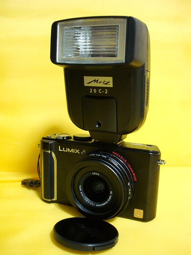

How about Metz 20 C-2?
Will it work with LX-3?
It will work but no TTL. Since you looking at METZ 20 C-2 why not consider the METZ 28AF-3 Oly?
Metz 28AF-3 can't bounch rite?
and also Metz 20 C-2 can be bought in local shop.....
Then get the FL36 lor... small (err.. not big lah... ) and still can bounce... use only 2x AAs... save battery and can do TTL too... :D
You are rite... Oly FL36/R seem like the only option... Panny FL220 - No tilt or swivel. No wireless TTL flash mode. AAA x2. It was launch just to solve the adapter bottom black out problem.
http://fourthirdsphoto.com/G1/05.php
How much is it selling in the market?
I've just bought the Metz 20 C-2 and it does work with the LX3, price is $105 at K13 Marketing, Peninsula Plaza.
HTH.
