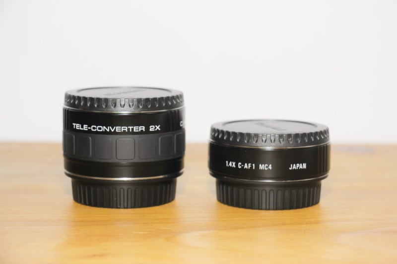

Teleconverters are handy lens add-ons that multiply the focal length of the lens they are attached to. They can be mounted in between the camera body and lens (typically a telephoto lens) and increase the focal length of the lens to which they are attached.
By how much is dependent on their power, which is stated as a factor. For example, a 1.4x teleconverter multiplies the original focal length of a lens by 1.4. As a result, a 100mm lens would turn into a 140mm lens, a 200mm lens would turn into a 280mm lens, and so on. Most common are 1.4x or 2x converters, but occasionally converters as strong as 3x can be found as well.

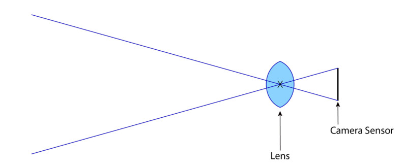

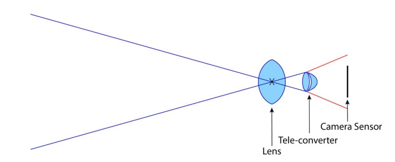

The reason for this effect is that such converters simply enlarge the aerial image that an existing lens is projecting and because we are only using the center portion of this enlarged projection only a portion of the light, that enters the lens, reaches the sensor; hence the light loss. The images below illustrate this effect:
Without teleconverter
With teleconverter
On the flip side, this means there is good news, too: since the converter merely enlarges an existing image, there is no effect on its depth of field, nor on the working distance, which can be incredibly useful in the field or with reflective subjects.

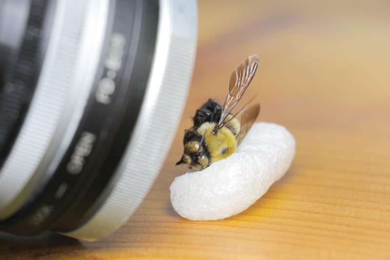

For this set-up I needed a large working distance to maintain proper alignment without catching a reflection of the lens in my footage.
