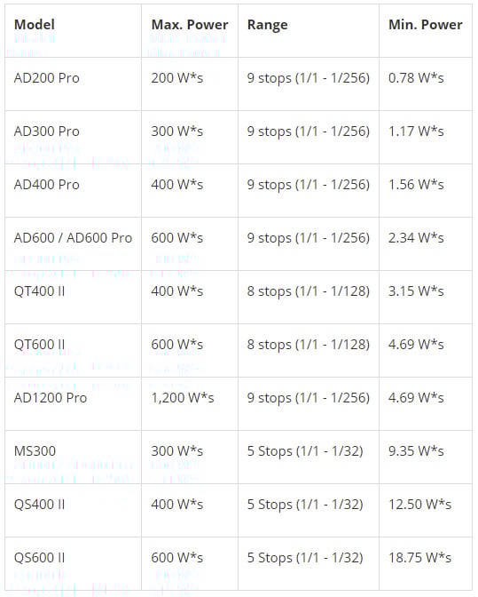

Here is a handy chart showing the current Godox lineup’s maximum power, range, and effective minimum power:
Maximum and Minimum Power Levels
If your strobe is too powerful, you could always use a neutral density filter. But it’s better to not need to bother with such things if you have the choice.
