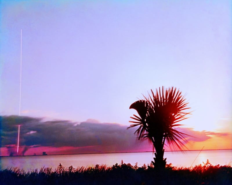

I had one 4×5 inch press camera, so I borrowed a second one from Sterling Hawk, a local commercial photographer who shot pictures for the Times and processed film for us when we shot our own. We loaded up a couple of cut film holders, one with color negative film, the other with black and white infrared film.
The infrared was easy: a red filter would turn the sky dark, and reduce the amount of light sufficiently for the long exposure. We had done it twice at the Cape: Arch did it first, then we did it again with our secretary Annie in the picture watching the launch.
The color was a new challenge. The film was much faster – I would have to find a way to reduce the light at least 8 f-stops, which I think is 1/256th the original amount. A 4x neutral density filter only reduces the light by 2 stops, so even if I stacked two of them, it would only give me half of what I needed.
But I had an idea: Polaroid made a special neutral density filter that enabled you to use their ultra-fast 3000-speed film in daylight. It reduced the light by 4 stops. Fortunately, the diameter of those filters is just big enough to cover the lens on the press camera.
But how to attach them? Polaroid put them into rubber holders that would fit over the lens of their Polaroid cameras, but not over the lens on the Graphic.
So I used tape. I got some black tape and taped one Polaroid 4s filter onto the front of the lens, and another onto the back of the lens.

As the count reached T-minus-3 seconds and they started igniting each of the five engines, I opened the lenses on both cameras. The color started fading at about that time, but there was more than enough color still left during the next 60 seconds for me to make my picture.
As the count reached Zero and the giant rocket began to slowly power its way up – right on schedule – people started yelling and cheering it on. The young woman next to me was jumping up and down and shouting enthusiastically, then she grabbed my arm and held on enthusiastically.
It felt good, but not good enough to make me forget about my picture. I reminded her to please be careful not to bump the tripod or the car. She quickly turned loose, moved a couple of steps away, and continued jumping and cheering. Then I wished I hadn’t said anything to her. Excited young ladies excite me. But to me, the job always comes first. (sigh)
After 60 seconds I closed the shutters on both cameras, loaded everything into the MG, and began my next challenge: To get back to the Times office in Melbourne almost 60 miles away by 8 a.m. I’d promised Pearl that I could do it.

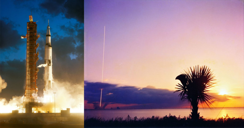

Mixed Results
The infrared film was fine. We developed it and made a print and published it on the front page of the paper. That afternoon, after that day’s paper was out, I took the color film to be developed.

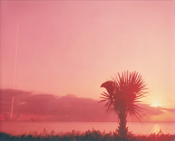

The picture I got back was a shock and a huge disappointment. The beautiful colors that had miraculously appeared just in time for the liftoff were all gone. Vanished. The whole picture had an ugly reddish color.
That is when I learned about “reciprocity failure.”
What happens when you use the wrong film
Ektacolor S film is for “short” exposures, no more than 1/10th of a second. Ektacolor L is for “long” exposures, longer than 1/10th of a second. The problem is that different colors of light are at different frequencies, different wavelengths, so when you have a long exposure, too many “waves” of certain colors reach the film.
Too many red light waves and too few blue ones had reached the film. Almost all of my work had been in black and white because virtually no newspapers had the technology to publish color photos back then.
I sent the negative to a couple of different photo processing labs and the prints came back the same.
A Friend to the Rescue

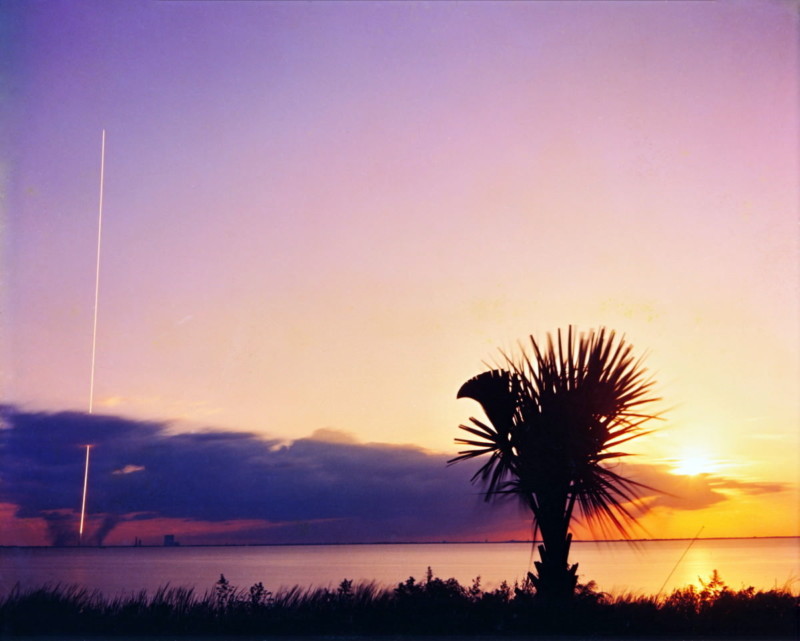

Then a photographer friend that I had met when he was a member of the city council told me about Color Lab of Florida in Ft. Lauderdale. I sent them the film with an explanation of what I had done and waited to see if they could help.
They helped and rescued my “impossible mission.”
They sent the whole series of test prints they had made. The first was the same as I had gotten from the other labs. The second was better, but not great. The third one was good enough. There was some blue in the sky, contrasting with the yellow and orange in the sunrise. It looks like the sunrise is trying to fill the whole sky. That was good enough for me. We were both very impressed with each other, and I continued to send all my color work to them for the next 25 years.
A color corrected photo
Then 50 years later, when I decided it was time to do something with my Apollo Launch Photos — the color versions have never been published anywhere before — I finally got what I had wanted all along.
I bought a couple of scanners — an old Epson flatbed scanner capable of scanning 4×5 film, and a CanoScan 9000F — and began experimenting.
The scanners are smarter than I am! The software for both scanners have a couple of marvelous adjustments: One adjustment lets you compensate for fading colors, the other is for “backlight correction.” Both offer three levels: light, medium, and heavy correction. So I tried all of the combinations to see what would happen.
Those adjustments fixed the photo! When I tried to see what I could do manually, it was never as good as what the software had done on its own.
Finally I have a photo that looks like the scene looked that morning more than 50 years ago: blue sky, pretty sunrise, the big blocky Vehicle Assembly Building clearly visible to the right of the launch pad.
