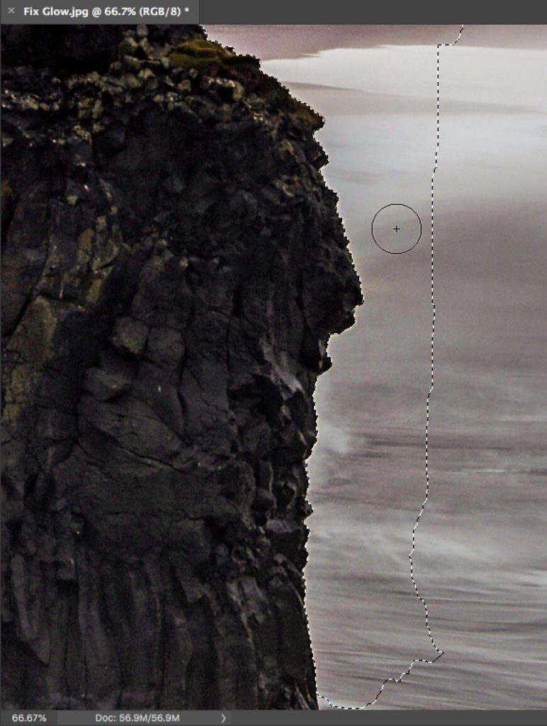

Check out the white glow around that rock formation. That needs to go!
STEP ONE:
Here’s our processed image (above), and you can see that it has a white soft glow around the outside of the rock formation in our foreground, and when we zoom in (in the next step), you’ll see a brighter thin hard white glow right on along the edges. Both are pretty bad, but actually fairly easy to fix.
STEP TWO:
On the left here I zoomed in close so you can really see that hard glow along the edges. We want to make sure that when we get rid of this glow we don’t accidentally mess with the edges of the rock, and to do that we put a selection around the area we’re going to work on — right up to the edge — and once that selection is in place, we can’t accidentally paint outside that selected area. It’s like we put a fence around it to keep our repairs inside. The easiest tool to put up this selection ‘fence’ is the Quick Select tool (choose it from the Toolbar) then you just paint with it along the outside of that edge area and it snaps to the edge as you paint (as shown here at right where I’m painting along the right side of the rock). You can change the size of your selection brush just like you would any other brush — the left bracket key on your keyboard makes it smaller — the right makes it larger.
STEP THREE:
Now switch to the Clone Stamp tool; make your brush nice and small (as shown here). Go up to the Options Bar up top and lower your Flow amount to 25% (that way, your strokes will build up as you paint over them with the Clone Stamp tool, so if you paint over an edge and it doesn’t remove enough, you can paint over it again and it will build up). Now, hold the Option-key on Mac (the Alt-key on PC) and click right just a 1/4” or so to the right of the edge to sample that area that doesn’t have a glow. Now move your cursor right along the edge (as shown here) and start cloning over the edge. If you look closely at the image shown here, you’ll see a little ‘+’ crosshair cursor just to the right of my brush tip. That’s the area I sampled (holding Option/Alt) to clone over my glowing area. If your glow is wider than just along the edge, you’ll see the same technique but with a larger brush tip, and you sample as close to the edge as I did here — You need to sample outside the area where you see the glow. That’s all there is to it.
