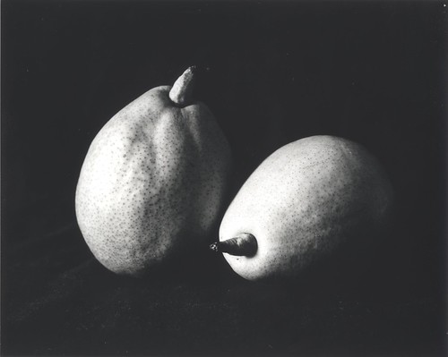

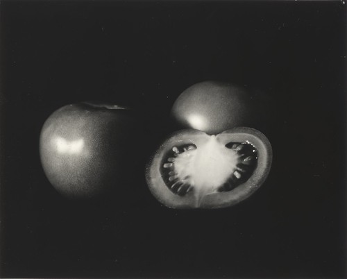

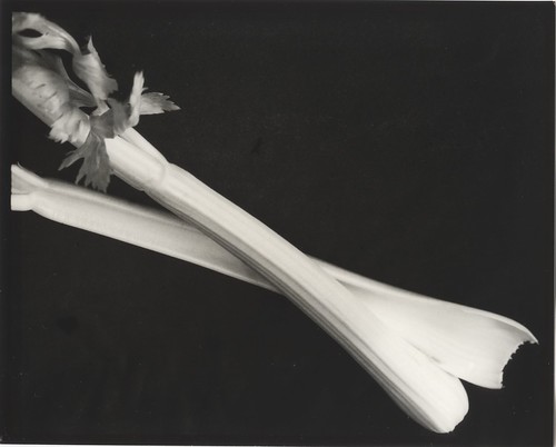

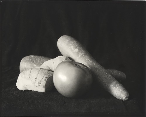

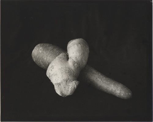

loving this series. don't mind sharing how you went about setting this up?
ahhong
Apr 6, 2008
360
0
16

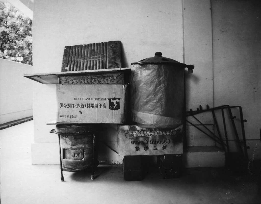

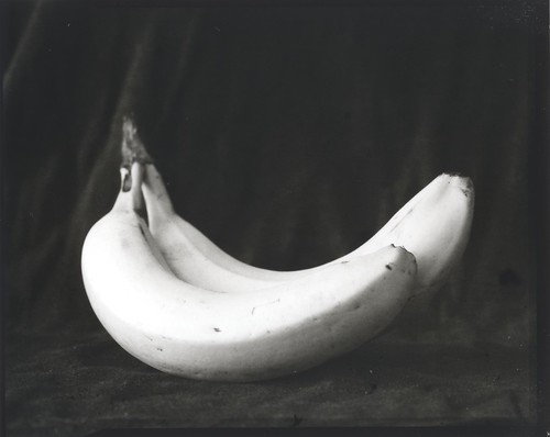

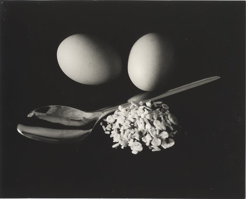

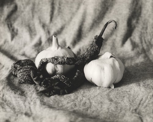

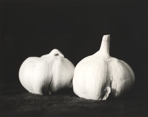

The set up was actually quite simple. They were shoot using a 4x5 field camera (since the paper come in 4x5 size), mostly with 210mm lens while some with 150mm lens. 'Back drop' was using a dark color t-shirt. Shot in door with available light from curtained window. All of them exposed for 30mins.:bsmilie:

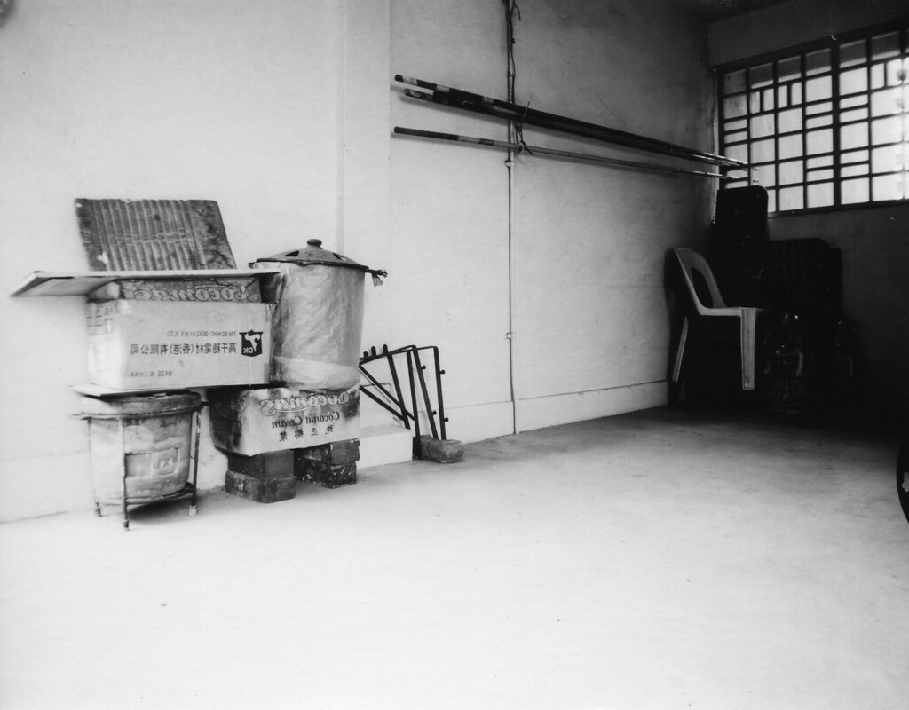

I finally found my prints! These are taken on Ilford direct positive RC paper 4x5 size. It was developed with E.I. 3. The contrast is very very high. I did not pre-flash the paper.
