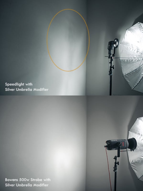

In the above image we see the same umbrella modifier being used on a strobe compared to a speed light and the resulting light they produce.
Ultimately it’s up to you what you use, but personally, I would never use a speedlight again. I’m not against speedlights and for wedding shooters that need a high volume of images and variety in short space of time, they can be invaluable.
My personal reason for not using speedlights stems from their lack of ability to spread light. Speedlights project light from a very small slot which is very difficult to convincingly modify in any meaningful way. Strobes have the ability to spread light in all directions around the flash tube which ultimately makes for a far better quality of light and therefore far more modifiable with a variety of modifiers.

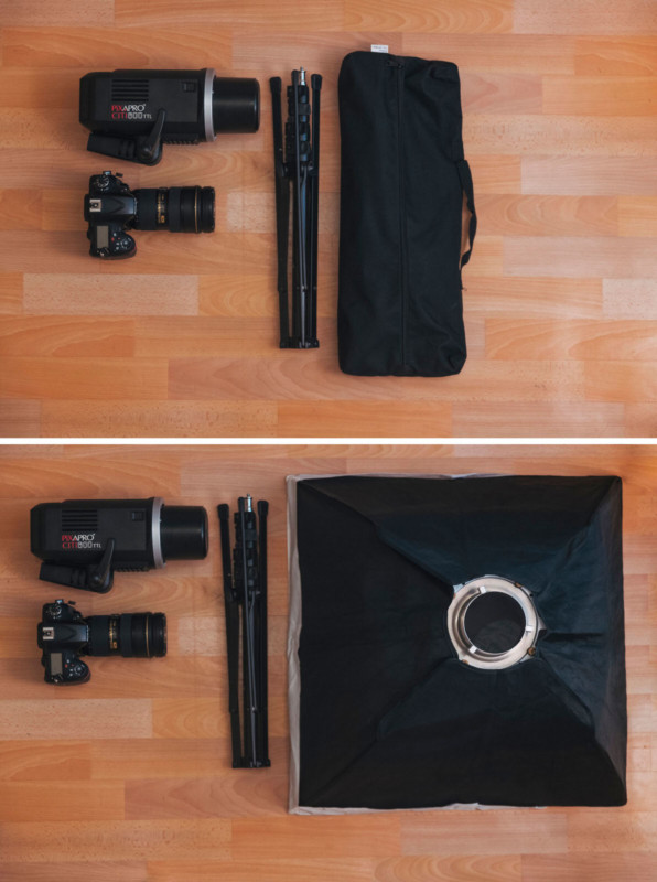

Small 60cmx60cm Softbox
Weight: 1kg (including speedring)
Size when assembled: 60x60x50cm
Size when packed away: 60x15x5cm
Assembly Time: 30 secs – 1 min
Price: £26 ($34)

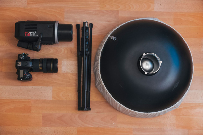

22” Beauty Dish
Weight: 2.7kg
Size when assembled: 22” (55cm) across and 25cm deep
Size when packed away: 22” (55cm) across and 25cm deep
Assembly Time: No assembly required
Price: £80-£150 ($100-$195)

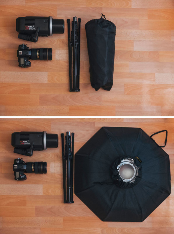

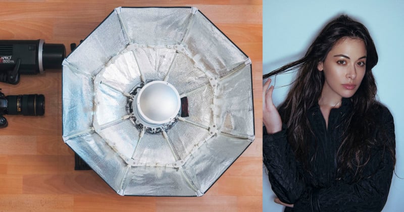

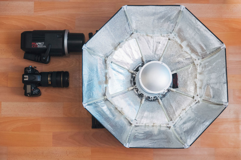

Collapsable Beauty Dish
Weight: 0.8kg
Size when assembled: 70cm across and 20cm deep
Size when packed away: 40x20cm
Assembly Time: 1 – 2 minutes.*
Price: £40-£60 ($50-$80)
* The assembly time on the collapsible beauty dish is very easy, but long due to all the struts needing to be clicked into place. No parts actually need assembling like it does with a softbox.

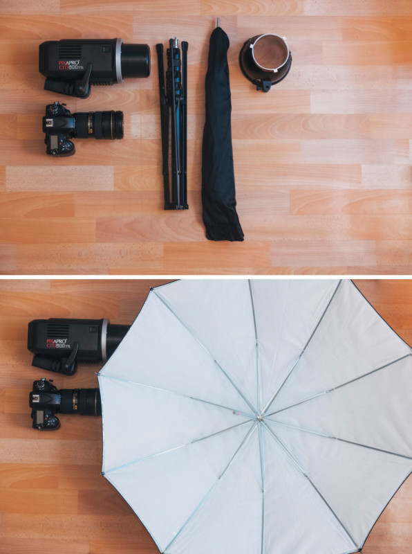

Small White Umbrella
Weight: 0.2kg*
Size when assembled: 90cm (36”) across with a 60cm shaft
Size when packed away: 60x10x10cm
Assembly Time: 10 secs
Price: £15 ($20)
* It is worth noting here that although many don’t use a reflector dish with their umbrella (you can often insert umbrellas into a dedicated hole on most strobes), I personally like to use one. You can see the reflector dish in the image above and it stores directly on top of the strobe head when carrying so takes up almost no extra room but adds about another 300g.

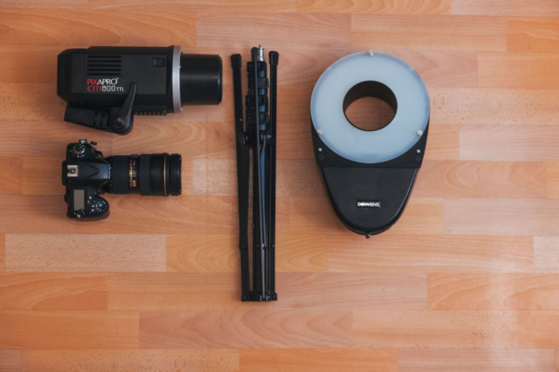

Ring Flash
Weight: 1.45kg
Size when assembled: 35x22x12cm
Size when packed away: 35x22x12cm
Assembly Time: No assembly required.
Price: £150-£600 ($200-$800)
Prices for ring flashes vary dramatically. I recommend doing some research into exactly what you need it for first.
The precise name of this is the Bowens Ringlite converter. As the name suggests, this simply converts the flash light into the ring shape and with your lens inserted through the center hole, the flash then seemingly comes from everywhere around the lens resulting in that very distinctive shadow pattern that surrounds the subject.
This was a wildcard modifier but one that I thought would be good to include. Although these are hard to come by now, you can get a multitude of other ring-light/ring-flash alternatives. I actually like this one as it weighs next to nothing due to it being completely hollow.

For me, if I was after a slightly more engaging portrait of a character then I’d go for the beauty dish. And unless I had a full-time assistant on hand, I’d go for the collapsible one over the studio one due to weight and ease of use.
Note: One of the only reasons I even included the full sized studio beauty dish in this test was to show just how good the far cheaper, collapsible one is by comparison.

The slightly softer light of the softbox is going to be more flattering on regular people like you and me, so if it was a wedding or family portrait, this might be a way to go.

The white umbrella produces a very soft and flattering light and although the small softbox does the same, it’s far more directional. If I had to shoot small groups of people together then I’d opt for the white umbrella as its ability to spread light over a large area is perfect for these smaller groups of 2 or 3 people.
