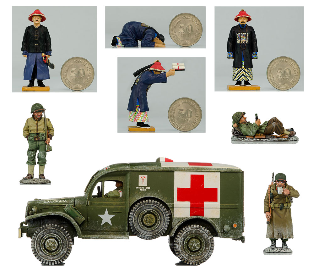

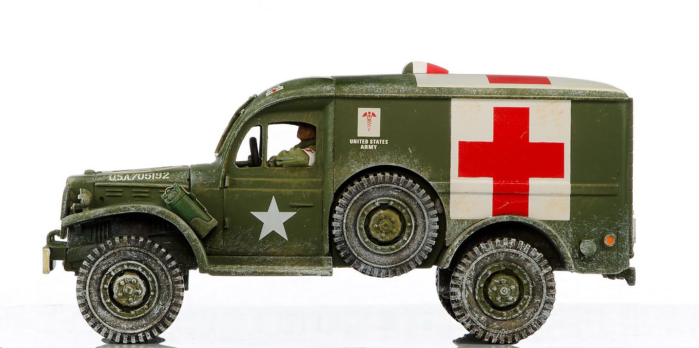

    A WW2 American Ambulance...
    BBA037-01 Dodge WC54 U.S. Army Ambulance (Winter Version) (King and Country BBA037-01)

    These vechicles are historically accurate.......
