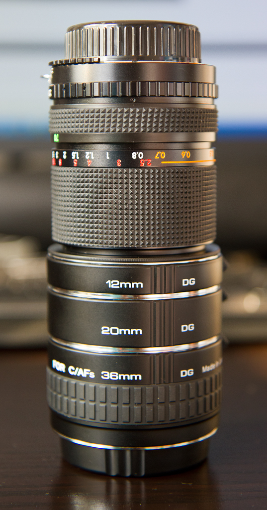

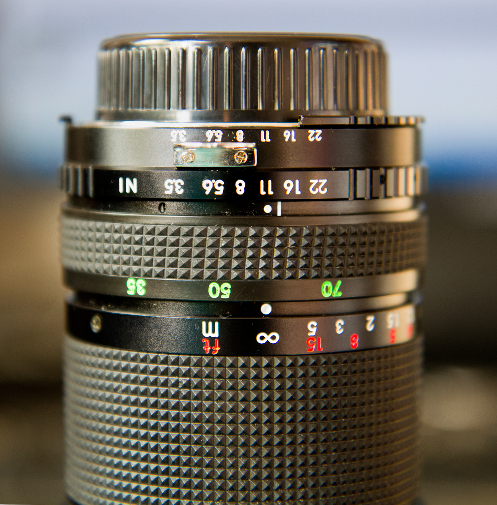

    Default Re: How to find Macro magnification of picture (1:1 or 2:1)?
    3 Kenko Tube, 1 Reverse Ring, 35-70mm lens with Aperture ring.
    I tried doing reverse 50mm macro but DOF was so thin that it was not able to get anything in focus. But using this lens i can set aperture with moveable ring.
    Now i need a good macro arm and diffuser for my 580EXII, then i will be good to take some newbie shoots .

    The whole setup for super macro cost less than $250. Am I right TS? The price is not high and the macro magnification can vary from 1:1 to maybe 4:1. I'm going to try that out too. Have all the parts to do that. Cheap fun.
    Lens - $80
    Reverse mount $20
    Set of extension tube $150
  10. #30
    Join Date
    Jul 2009
    Location
    Jurong
    Posts
    2,036
    @Ronken, you are absolutely right. It is very steep learning curve and require a lot of patience.
    I was planning on buying MP-E 60 but end up having this setup, which giving me quite promising result given that i can understand light.
    @shierwin, you are right.
    You will need
    1- Extension tubes. (175$ kenko set from ebay, around 200$ from cathey).
    2- Reverse ring (around 5$ from ebay, maybe 10+$ from peninsula plaza?)
    3- 28mm prime lens with Aperture control (check this video, really some thing ) (<100$)
    4- Flash with softbox (i order my softbox today @ 6$SGD from ebay).
    5- Flash bracket (trying to get one, don't know if can get a cheapo deal or not).
    175 + 5 + 100 = 280SGD
    In contrast if you get MP-E 60mm it is around 999USD from B&H + 48.46USD UPS charge= (exchange rate 1.2136) 1271.2 SGD + 7% GST (182) = 1452SGD.
    280SGD Vs 1,452SGD
    All figures are rough estimate.
    5D3|35L|50f1.8II|580EXII

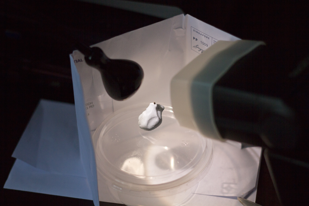

    Now can this shoot be improved using better light?
    BTW here how the light setup look like (Ikea light to get the subject infocus)
