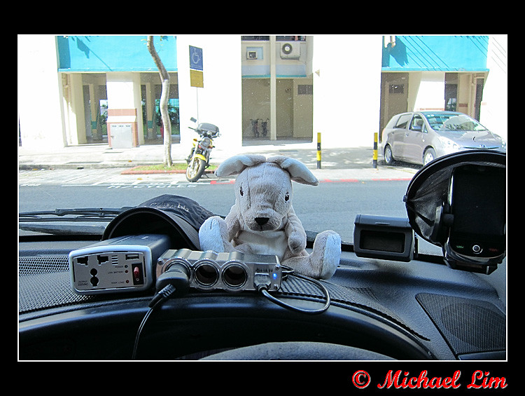

    I'm using the Belkin one. Available from certain Home-fix outlets.
    Pretty reliable.
    it's the one on the left

    Thanks for the info! Does the cigarette port have enough power for both the laptop and a GPS unit? My plan is to get those extension units like zac08's and plug in both the converter (with laptop) and the GPS.
    I've read that the port can only do 120W max, isn't 400W too much for it?
    Sorry, Sleeping when I posted last. Should be 140 watts. 400 watts is only for units that hook up direst to batt terminals. As for the enough power for 2 items, flip over the power bricks and do some maths.
