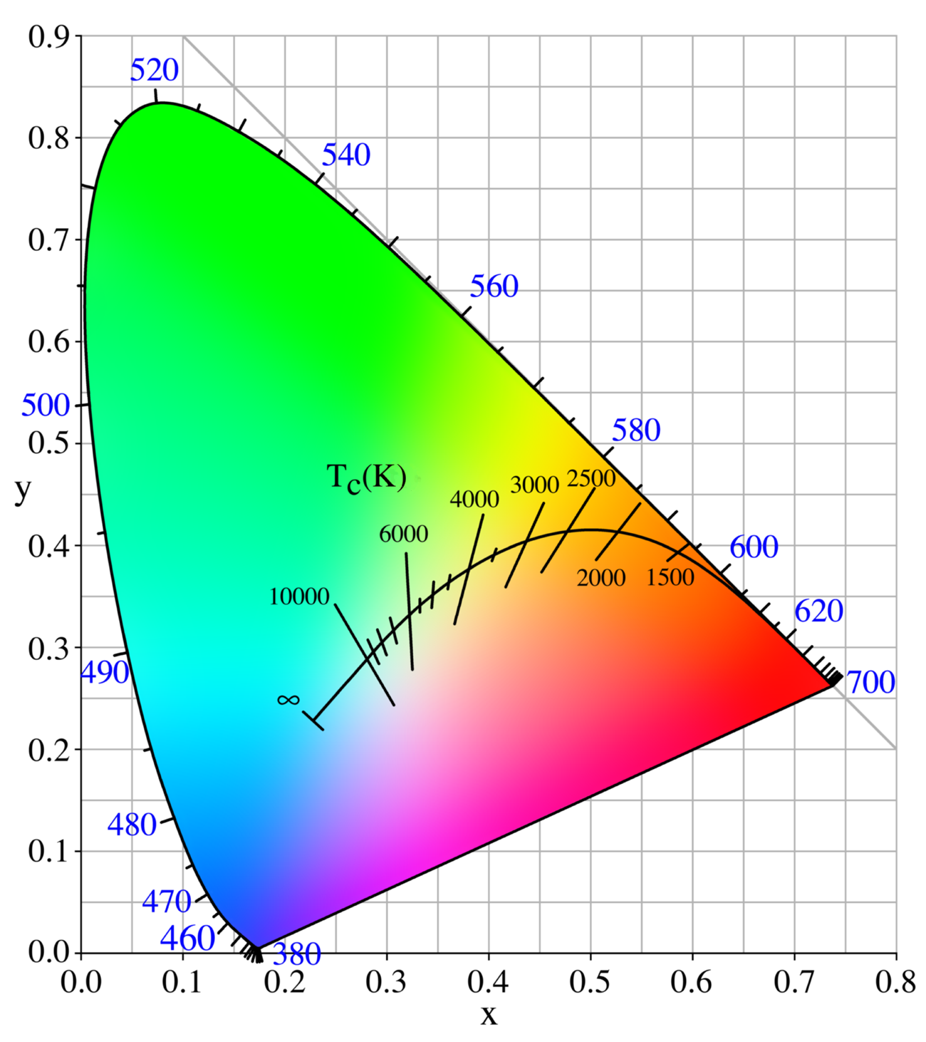

    You got it wrong, the lower the Kelvin or K, the warmer the color, and vice versus.
    image taken from Wikipedia. sorry for the huge file, but I don't want to alter the graph.
    Spyder calibration software isn't know for high accuracy. you may download the 14 days fully functional basICColor Display calibration software to double check.
