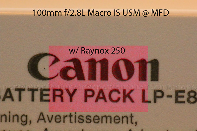

    my 1st shot with Raynox 250

    Quote Originally Posted by Diavonex View Post
    Pretty good for 1st shot
    What lens did you attach it to? e.g. 50mm or 135mm
    on 100L, thanks!

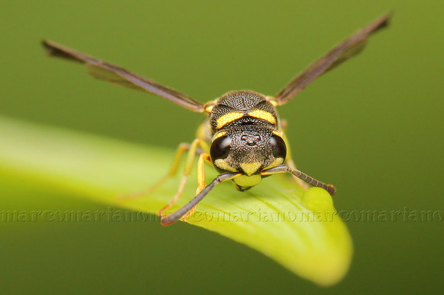

    Default Re: Raynox DCR-250 Macro Conversion Lens Review
    hornet [raynox on 100L]
