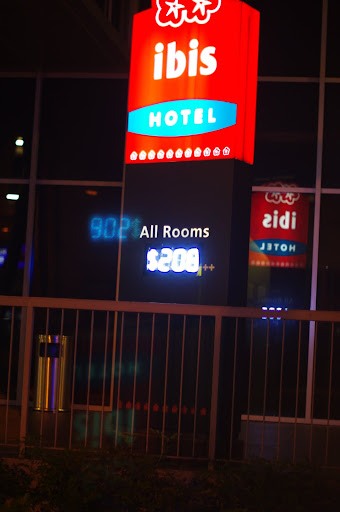

    HI ALL I HAV A REFLECTION ON ALL DA PICTURE WHEN I TAKE AT NIGHT
    1.http://www.flickr.com/photos/35301792@N03/5059274308/
    2.http://www.flickr.com/photos/3530179...n/photostream/
    3.http://www.flickr.com/photos/3530179...n/photostream/
    SO HELP ME SHOULD I TAKE DA LENS FOR SERVICE OR CLEAN MY SELF
    WAT IS DA PROBLEM

    Pretty nice ghosting - Read up more about flare:
    http://toothwalker.org/optics/flare.html#filter
    Quote Originally Posted by jejem View Post
    WAT IS DA PROBLEM
    I can see a problem with your caps lock and your language. Beside this, taking off the filter will help to remove the flare / ghosting. There is nothing to clean.

    sorry to all member of CS who hav reply to my post .. I even took out the filter but i can see the glare

    What lens are you using? Any adaptors, etc attached?
    Alpha
  8. #8
    Default Re: Have a reflection on da picture
    Canon EF 50mm f/1.8 II with hoya filter attach

    You can try by Removing your filter and use a lens hood, It might help in your case. (=

    Look at the 2nd pic on the reflection of the block number. I don't think a hood will help.

    Second pic reflection should be due to the Filter so for second pic remove your filter and try ^^ KEke

    I even took the filter and tired but i can c the glare

    If you get the same issue even without the Hoya filter, then it's just a property of the cheap lens. Nothing you can do except try a smaller aperture or learn photoshop.

    It's called flare. Can happen for many reason, most common suspects being the filter and your angle to light source.

    Icic, then try taking at different angle or position. this is what i normally will do. If flare still appear in your photo after changing a few angle or position, then i think the place is not suitable for taking photo lol
    or another alternative is you can erase the flare away by using Photo Shop
