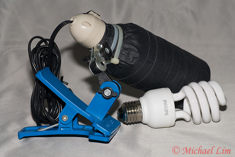

    Btw, this is an example of my DIY light tube complete with snoot.

    Quote Originally Posted by zac08 View Post
    Looks handy! How much does it cost in total? I might consider setting up my own DIY lighting too

    Pretty cheap actually... the light fixture was only $6 or $7, from a small lighting/hardware shop. The clip portion attracted me.
    The bulb was the expensive one, abt $10+
    The snoot was made out of Lay's potato chip tube and gaffer taped.
