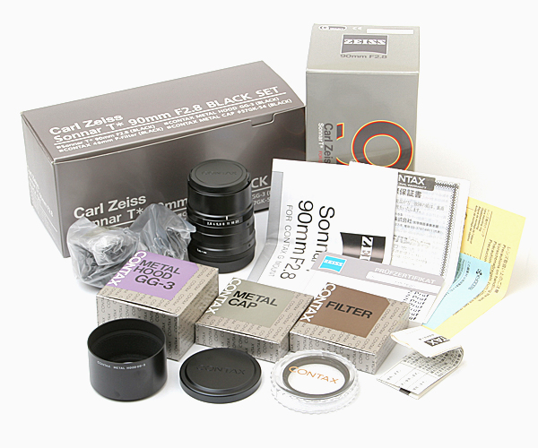

Default Contax Carl Zeiss G Sonnar T* 90mm f/2.8 (M-mount)
Took a long time to find a black 90mm Sonnar and convert it. Original box:

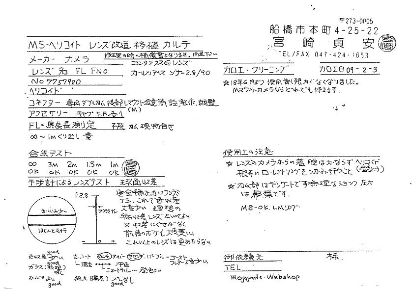

Test and calibration report:

TRANSALATION:
Left lower corner translates roughly as:
Round figure is an image from interferometer
...colour distortion (ie. CA) is small ... good
...glass has no "striae"
...glass has good polishing/making
Right of the above figure is diagram of spherical aberration
...full correction & bump is very small
it can be said that this lens is an almost perfect non-aberration lens,
it has very good front and back bokeh, and you cannot find a better
lens.
...multi magenta coating and good against flare and ghost
...neutral colour rendering
...good construction i.e. lens has no de-centering

I am impressed by the extend these Japanese technician do their job.
Deep technical knowledge not only in machining, but also in the field of optics and photography...
A model we should learn...
