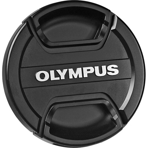

ClubSNAP Photography Forums
Go Back   ClubSNAP Photography Forums > Equipment Discussions > Four Thirds Standard (4/3 and m43)
Four Thirds Standard (4/3 and m43) Four Thirds and Micro Four Thirds Discussions
Thread Tools
Old 19th December 2007   #1
Blu-By-U
Join Date: Aug 2006
Location: Selangor D.E.
Posts: 1,417
Default Replacement Lens Caps - where to find?
Where can I find replacement lens caps in Singapore. Generic without any brand would be favored. And pinch type. 52, 58, 67, 72 and 77.
http://www.bhphotovideo.com/images/l...ges/486371.jpg
__________________
World thru my lens
Blu-By-U is offline
Old 19th December 2007   #2
Khair76
Join Date: Apr 2006
Location: Pasir Ris
Posts: 121
Default Re: Replacement Lens Caps - where to find?
I bought one for $5or $8 I think. It was at cathay photo peninsular branch.
No brand indicated infront and it's a pinch type...
Construction wise... well... for $8 bucks... don't expect too much...
Khair76 is offline
Old 19th December 2007   #3
Blu-By-U
Join Date: Aug 2006
Location: Selangor D.E.
Posts: 1,417
Default Re: Replacement Lens Caps - where to find?
Thank you..Cathay Photo, Here I come.
__________________
World thru my lens
Blu-By-U is offline
Sponsored Link
Old 19th December 2007   #4
boopoo
Join Date: Apr 2004
Posts: 1,395
Default Re: Replacement Lens Caps - where to find?
Isnt the want you shown on picture interior clip woo mr getting too
boopoo is offline
Old 19th December 2007   #5
Kirika
Join Date: Aug 2007
Posts: 721
Default Re: Replacement Lens Caps - where to find?
Don't forget The Camera Workshop...in the area, too
Kirika is offline
Old 19th December 2007   #6
boopoo
Join Date: Apr 2004
Posts: 1,395
Default Re: Replacement Lens Caps - where to find?
is 14 buck for 67mm not $8
boopoo is offline
Old 21st December 2007   #7
Blu-By-U
Join Date: Aug 2006
Location: Selangor D.E.
Posts: 1,417
Default Re: Replacement Lens Caps - where to find?
Generic also cost so much?? USD3 only from the lens cap shop.
__________________
World thru my lens
Blu-By-U is offline
Old 21st December 2007   #8
boopoo
Join Date: Apr 2004
Posts: 1,395
Default Re: Replacement Lens Caps - where to find?
Just bought today 67mm and 62mm $6 eash. Will try if it good i buy another 52mm and 67mm
boopoo is offline
Old 22nd December 2007   #9
Blu-By-U
Join Date: Aug 2006
Location: Selangor D.E.
Posts: 1,417
Default Re: Replacement Lens Caps - where to find?
Originally Posted by boopoo View Post
Just bought today 67mm and 62mm $6 eash. Will try if it good i buy another 52mm and 67mm
Where is that shop? Name and address please.
__________________
World thru my lens
Blu-By-U is offline
Old 22nd December 2007   #10
Hitman
Hitman's Avatar
Join Date: Dec 2004
Location: 22° 11' N, 113° 33' E
Posts: 794
Default Re: Replacement Lens Caps - where to find?
Here's a local supplier you can try;
www.perly.com
Look under 'Lens Accessories'.
Have a good weekend!!
__________________
Pictures always should have a special story behind it or a special meaning to the photographer.
Hitman is offline
Old 22nd December 2007   #11
VSonic06
Join Date: Dec 2006
Posts: 808
Default Re: Replacement Lens Caps - where to find?
Some third party lens caps have a slightly wider external diameter which gets in the way of reversing the lens hood while the cap is attached. Bothersome to some but might be a bonus for those who often forget to remove the lens cap before shooting.
VSonic06 is offline
Closed Thread
Bookmarks
Thread Tools
Forum Jump
All times are GMT +8. The time now is 08:04 AM.
Page generated in 0.08960 seconds with 7 queries
