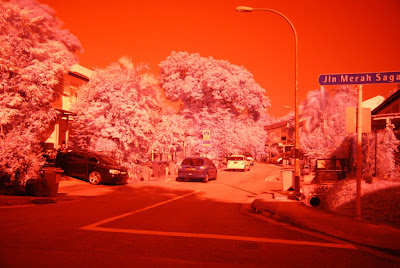

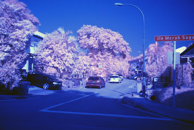

Hi, guys. I'm quite new to the IR photography. Had a few pointers from some friends and tried the IR shot.
WB setting at the following. ISO800, Shutter 30sec, Aperture 5.6/6.3 photo to point to.
Had read up about the IR setting. So far, I set the WB to use a pic taken with the IR filter on. When I took the pic and try to pp, this came up. Can't adjust anymore or it'll look weird.
Can anyone help on this? Is it my WB setting still not right?
Before............................................ .............................After

Are you using Auto WB or Preset WB?
It looks like your WB is wrong.

I using Preset WB. Ya lor, I also find it weird why cannot remove the blue color.

Hi... I using D40 and was unable to set the CWB too. But I think its fine coz u can photoshop it. I tried doing for u, though I not v good at it but this is wat I get.
I tend to get a blue cast everytime I try coz I always try to make the sky blue so tis time I try not to fall into the "trap" again. Francis is this WB ok?

I still find it quite bluish. Maybe my WB setting not correct, will try again. Thanks for trying. My ideal is to get leaves white and overall balance color and not too blue or artifical.
I suspect D80 n D40 have very good IR filter in the system that it reduce the IR intake and hence, we have difficulty getting IR correctly.

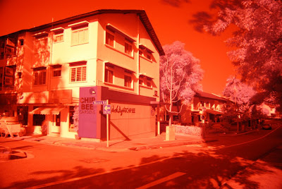

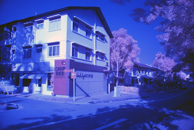

Hi guys,
Recently, I'd reset my IR setting and run a test again. Tried to pp and still can't get the leaves white.
Can someone kindly help in this?
Don't know where went wrong?
Is it that the IR photo not bight enough?
Meaning exposure not high and duration not long?
Is it over expose or under expose?
Original.......................................... ............................After PP
Photo taken with IR WB, f/5.6, 25s, ISO800, EV 0.00.
Photo taken with IR WB, f/5.6, 30s, ISO800, EV 0.00.
Is the above closest that I can get with the leaves white like snow? Is the exposure too bright?
Btw, when I set the IR WB preset, i tried a few combination and the system says it's good to go. Setting of ISO800, f/5.6 with 5s, 10s, 15s, 20s, 25s, 30s. Seems the cam accepts everyone of it. So which one to keep? The above uses the one with 5s.
