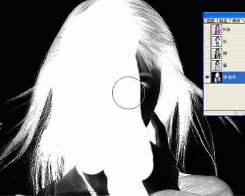

    1. Explore the RGB channels for the channel that shows best contrast for body and channel that shows best contrast for hair.
    2. Duplicate body channel and levels to get a defined edge (Just as shown in the picture in my first post)
    well, the question is..after leveling and burning (as shown in the black and white pict), whats the next step?

    Default Re: [HELP] Masking Techniques Using Channel (Hair/Fur)
    HI`English said the bad, I hope you can understand. Distribution of the map!
    Eraser tool with the brush into some white : # FFFFFF
    用橡皮擦工具将需要的部分擦成白色:#FFFFFF
    Not part of the eraser tool with a black rub : #000000
    将不需要的部分用橡皮擦工具擦成黑色:#000000

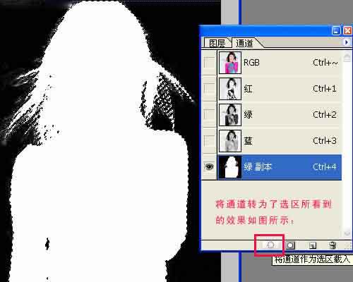

    将已经涂成白色需要的部分载入选区`
    Tu will have become part of the white printed in the constituency `

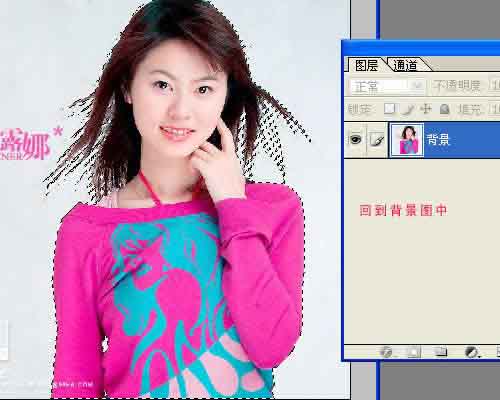

    再回到图层,需要的地方已经被选出来了.
    To return to the layer, the local election has been out

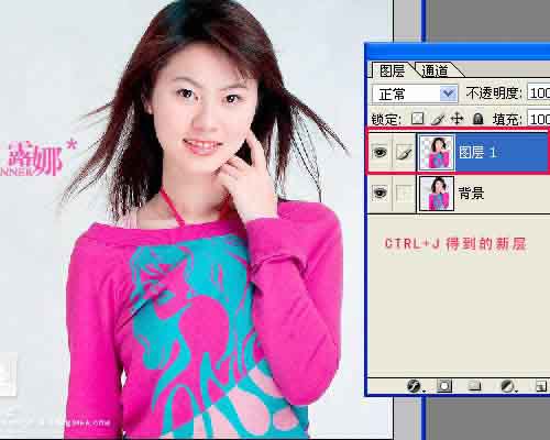

    CTRL+J..拷贝选区到新图层.您就可以为它换背景了!
    CTRL+J .. constituency copy of the new layer. You can believe it for the background!
