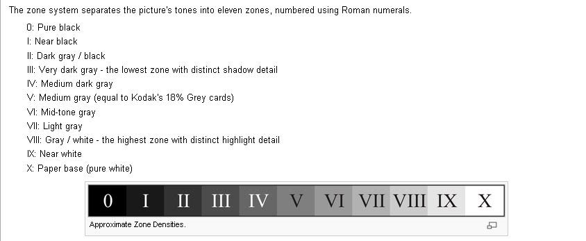

In comes the zone system. Here goes! Now, imagine the scene as a series of tones. If you don't know what tones is, just look below. As you know, light is not always constant throughout the scene, so each part of the scene will have different tones . Now simply divide each part of the scene into a table of 11 tones.
Below is an exercise..just match any area of the photograph to the table of tones below.
(Credits to Wikipedia for the tone charts)
Simple exercise isn't it? Now you're get the idea about dividing up a scene into an exposure of 11 tones. Now, the spot meter reading gives the tonality (dull concrete rem?) of Zone V.
