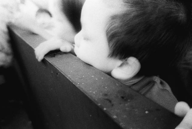

here's one taken with xa4 at close distance.

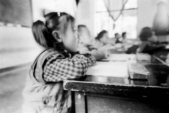

here's another one with xa4 when i went to yunnan last year

Yup most of my close focus shots at f2.8-4 or with flash turns out like Sathea's, even at speeds above 1/60. Gives you an artistic feel with black & white film but sucks when using color film. The XA that I'm using has a rangefinder for focusing, unlike the zone focus of the XA4. So I guess it is a design limitation rather than a problem with my camera. This means that the rf isn't really that useful. Having said that, the camera performs well for its size when stopped down to f8, so when taking subjects at close distances just remember to stop-down. Pictures taken with lens wide open are also useable when focused at subjects 3m and above.
