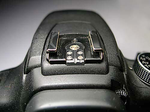

    HORSEshoe and HOTshoe are 2 different things.
  8. #28
    Moderator catchlights's Avatar
    Join Date
    Sep 2004
    Location
    Punggol, Singapore
    Posts
    21,901
    Default Re: Flash Sync Speed set at 1/250 but picture was taken at 1/500 on P Mode, why?
    Quote Originally Posted by eleveninth View Post
    they don't look alike too...
