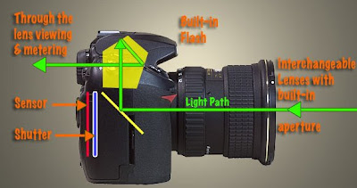

    If you are using a DSLR (i.e. typical camera with changeable lens and mirror and optical viewfinder), dust on sensor will not show up when you look through the viewfinder. The sensor is hidden by the shutter mechanism.
    (see photo below for clearer explanation)
    http://3.bp.blogspot.com/_mMHvIAd8RH0/SP6SZ86PH3I/AAAAAAAAAn0/-0WxpdlJ9ZU/s400/Nikon_lightpath.jpg
    Similarly, dust on viewfinder, prism, mirror, or focusing screen will not show up in your captured image.
