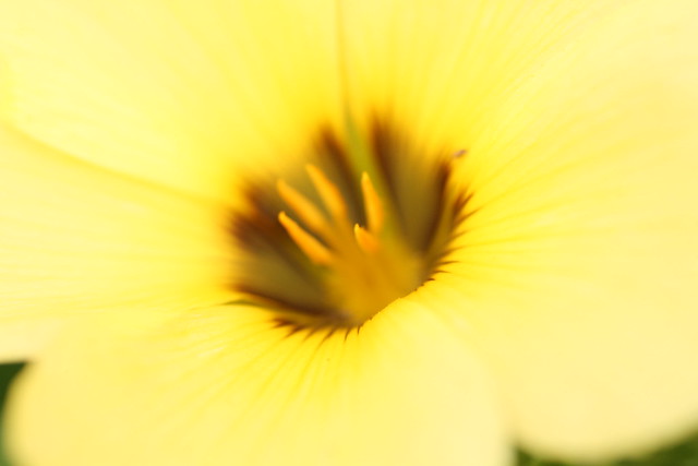

    Hi all,
    Thanks for the comments. I have posted the pictures below. For your advise. Thanks so much.
    1/160, f2.8, ISO160

    From your photos, I believe that the issue here is not about camera shake or slow shutter speed. Its your DOF that cause the blurriness.
    If you are trying to get the entire flower or most parts of the flower in focus, I suggest you stopped down to at least f/8 or smaller.
    For macro photography, what you often need is deeper DOF which f/2.8 could not achieve.
