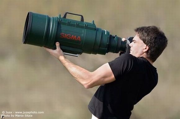

    Default Re: Why would ppl pay so much to save iso?
    Quote Originally Posted by cks2k2 View Post
    TBH no sane person is going to handhold the large aperture super-teles.
    If there's a will, there must be a way.... it just takes some training
    Quote Originally Posted by brkit View Post
    If only if my arm is that muscular.. I may give it a try.
    AND if my wallet is that fat to buy that monster.
    Well, that person is clearly insane.
